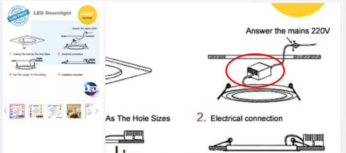

For this particular brand : Philips Meson 17W (https://www.lazada.com.my/products/philips-meson-led-downlight-5-6-13w-17w-led-philips-downlight-59464-59465-59466-59467-i1135416669-s3222830184.html?), is this with external driver or built in?
Is the red circle the driver that comes with the downlight or "something" my electrician has to install for me as part of "installation of lightning point"?

SUSslimey
post May 6 2021, 11:15 PM
6,914 posts
Joined: Apr 2007

philips is built in.
driver always comes together with the led light if external driver

QUOTE(vernee26 @ May 6 2021, 11:14 PM)
TQ!
This is what I have currently at my home, just screw in/screw out.
Would you go for this kinda e27 bulb or a LED downlight like Philips meson?
Cheers!
https://www.lighting.philips.com.my/consume...light/5920431H1
Philips Meson is built in. so the wires terminate directly to the light fitting. i suggest you ask the electrician to add an external connector so its easier to change in the future.

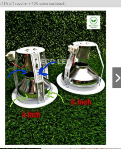

hi fireballs,
1. may I know where you getting your casing from? I went to 2 light shops today. both shops don't sell it
shopee and lazada can easily find, but I read that there's quite a bit of difference in quality right? (such as the reflector and casing).
2. Gap you mentioned is between the ceiling and the bulb itself? Are the gaps as per the blue and green arrows?
3. Having this sort of casing would require at least 5-6 inches of space above the plaster ceiling?

1. Mine from shopee. Mine is square 6inch.lagi difficult to find. Only 2 3 seller I remember. Led is quite directional so the quality of reflector is less important. The diffuser of the led bulb does most of the job.
2. Gap is at the e27 socket and the reflector cone on top. Compare to the flush lamps that don't have gap lah.
3. Yes. Measure first.
