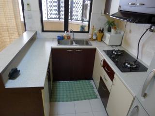

what is the most preferred method to change the formica on dark brown design wardrobe & cabinet?
do we just get new formica, customized into size and stick it over it...
or those cabinets have to be dismantled, and to be changed in the factory?
are the cost expensive vs doing up a new one?

you can try redo the door.

most suitable is to let the carpenter bring back the cab doors to change them. as for the side, they can try to peel it off on site, as with the usual kitchen cabinets, theyre mostly nailed on to your floor/wall so no chance of taking it out without destroying it. or, u can stick it over if the current one is of matte/rubber glue adhensivable and u dont mind have the new laminate sticking 1mm thicker.

Thanks fuzagi.. will it cost me an arm & leg to do it?

nope, about a few hundreds to a thousand, depending on choice of laminate and how much the carpenter wanna squeeze from u
