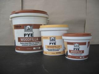

arr..those normal hardware shop don't know got such type/brand or not...
normally hardware shop sell which type of wood filler? same purpose? need to becareful buy wrong type?

PYE

PYE is the brand or? PYE wood filler?
can get from most hardware shops
If the cracks are small PYE would be as good. However deep scratches require wood filler or epoxy as PYE does not bind very well and cracks etc. I use either depending on what is the extent of damage (PYE is a lot cheaper).
