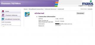

I got the way to access!
Username : Administrator
Password : <access key> at the back of your router label.
To enable public address (port forward), change your username to public.maxis.com.my
example : xxxx@home.maxis.com.my to xxxx@public.maxis.com.my
And now you should able to get ping from out of your house. Cheers!

TSJuno_wong
post Nov 22 2011, 12:23 AM
15 posts
Joined: May 2006
QUOTE(alexdokko @ Nov 21 2011, 02:53 PM)
Log-in/Pass not working.. can't access router.. Tried by my friend
Did u try properly? Below is my screenshot of my current connection.
alexdokko
post Nov 22 2011, 09:12 AM
7 posts
Joined: Oct 2011
QUOTE(Juno_wong @ Nov 22 2011, 12:23 AM)
needed to reboot the Gateway to work. Thanks!

Cola
post Nov 20 2012, 10:55 PM
585 posts
From: Klang / Shah Alam
just call maxis and tell them you need public access for the router...
they will fix for you...
here's my screenshot.. with user MaxisBB ...
i also had the problem login with Administrator ...
with the password behind my router
