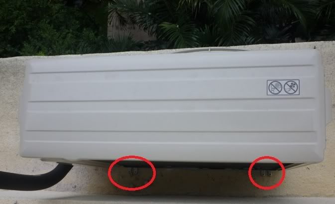

i need some help here. I just installed an aircon for my room, and i saw that the outdoor compressor unit have no screw to hold the compressor. Is this normal?
The compressor is kinda light and i can simply lift it with 1 hand. What i worry about its because i stay at 7th floor, the wind sometime get stronger, so there is a potential the wind will cause movement to the unit. Another thing is that after a long term of usage, the compressor may start to get vibrate and moving thus cause movement to the unit too. At the end, the outdoor unit may suicide itself from 7th floor. Does my worry sound extra or i should take precaution on it?? icon_question.gif

You better ask the installer to screw it, just to prevent it accidently move by someone...
Just insist "I want it to be screwed"...
nandayryu
post Sep 16 2011, 07:04 PM
1,072 posts
Joined: Aug 2007
From: Where theres an open-road state
it supposed to be screwed,only irresponsible installer will leave it unscrewed
acbc
post Sep 16 2011, 07:05 PM
9,048 posts
Lazy man's job la... how much for bolts? Few cents? Better bolt it down or else u might kill someone should the unit 'flew' off.

at least 2 screw.

I asked the person how come dont have screw on it, he said he installed few hundred unit like this and nth happen. Then ask back me "Why other ppl nth happen but u wan to do it?" and keep said the floor that put the outdoor unit cannot put screw, need mounting. I tell him its about safety and even the mounting also mount at floor or wall, any different on that?!
then he said "want screw can, need to add rm 30 for the screw". then at the end he said "need add rm 30 wor, u got the money mah??!!"... i was like WTF, i am the unit owner!~ so i just hang up and gonna find someone else to help me done that. biggrin.gif
Added on September 16, 2011, 7:17 pmAnd another problem is the aircond piping. My room have pre-installed aircond piping where i dont know its original from the unit or installed by the ex-owner. I always hear water dripping inside the wall whenever the aircond is on, not really sure is it the sound between water and pipe or the sound between water and wall.. rclxub.gif

Another bad contractor spotted!!!From the photo can see clearly if wind blow harder the outdoor unit may fall down even through that unit is weight more than 10kg.
This is what i thinking. I can easily move it with 1 hand, while 1 hand grabbing my window frame (high floor, scary tongue.gif).

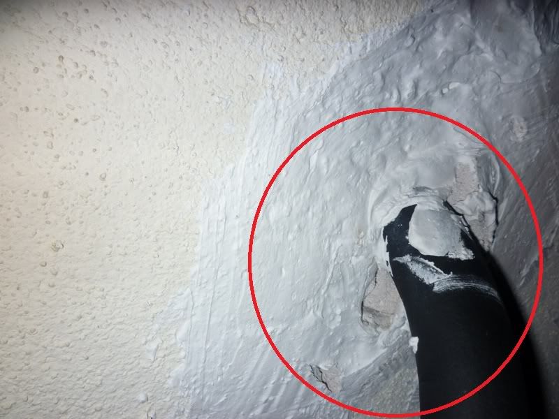

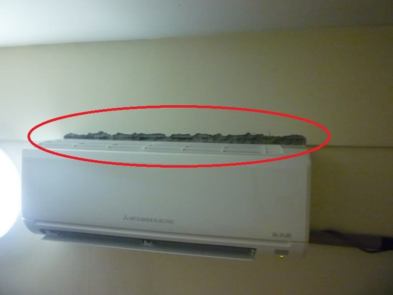

Ya, if the thing fall, sure goes serious 1... dont want to take the risk~ His name card as follow:
He is the contractor, not the seller. The things he does:
1) drill my wall without my consent just to avoid the aircon indoor unit. Actually he only need to install the indoor unit 2cm lower then everything will be ok, no need to drill at all. When i found out, he already drill 30% of the wall edi, cant be stop. cry.gif
2) After the piping, the wall is not fully seal off, still got some uneven surface with visible concrete.
This post has been edited by UltraConductor_41: Sep 16 2011, 08:50 PM

QUOTE(mlm boss @ Sep 16 2011, 08:57 PM)
it is normal that the compressor leave it sitting on the cantilever slab like that, coz the copper pipe and power cable are strong enough to hold the compressor itself. long term no issue on safety. it is easy for your maintenance oso. btw, the air blower unit in your room is not professionally done. the air con contractor should not leave the hacked area like that. should plaster or seal off with suitable compound. The exposed condensed pipe and power cable should concealed in wall or box up. Aesthetic wise, terrible. if u want, ask them to rectify for u. or u can refer to tribunal to claim your loss and damages.
i see, but since the workmanship already this bad, i better ask someone to come and screw the compressor first. I worry if the piping is not fully tighten up, then it will not strong enough to hold the compressor. tongue.gif Is it mean that all the piping and the wiring should be in trunking? because current 1 he got wrap it with a black color insulator foam.

QUOTE(UltraConductor_41 @ Sep 16 2011, 07:59 PM)
Hi all,
For safety reason the compressor should be secured. No question on that.
However, since this is located at high levels, fastening the base of the compressor is also going to pose a high risk.
How is the worker going to reach the base of the compressor?
Later on, when there is a need to service the compressor, how is the worker going to reach the base of the compressor to unfasten the holding down bolts?
A good installer would have install a MS bracket that is attached to the wall. Since the fastening bolts are higher up, they can be access easily from the opened window. The base of the MS brakcet will prevent any slippage and movement of the compressor.

The cantilever is just outside of my room window and it is about 3m x 0.7m. When he install the compressor and the piping, he already climb out and reach that place from my window easily. Im sure when doing the servicing, worker also need to climb out, disconnect the piping and bring in the compressor also. with screw or without screw shouldn't different much, hope im correct. smile.gif
The MS bracket that you mentioned will surely give a more easier servicing and security purpose for this~ tongue.gif
