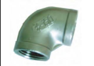

When you get quote, please ask them to use Stainless steel / Brass / Copper elbow threaded fitting on the wall. The advantage is when come to replacing tap or taking and removing multiple time of tap you won't lost the thread. Using PVC / uPVC elbow fitting you risk loosing the thread and need hacking to replace the entire elbow.
Don't use GI, it will rust.

any pictures of how these elbows should look like?

Sorry don't have. Most of my house tap already install.
The contract should know. And before installing the tap you can see if it PVC, Brass, Stainless Steel or Copper.

Quite true. Avoid having those pvc threaded fittings. They are bound to give you problem in years to come.
Brass fittings
Copper fittings
Stainless steel elbow
