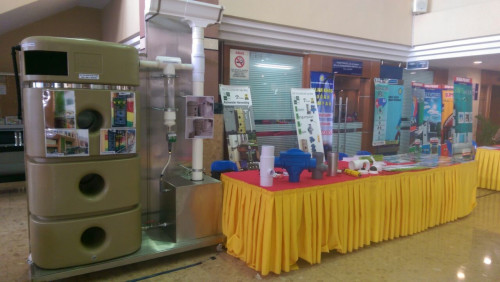

this tank
http://www.ddtechniche.com/images/pdf%20fo...tank%20v5.0.pdf
seems reasonably sized in terms of dimensions and water storage capacity, just sked the price will cause a heart attack..
cause a poly tank for abt 200 gal/750lit cost about 450-500 bux, if its priced in the same range then it would be good

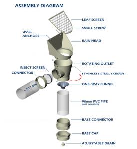

you can try this
product document , Attached File  leaf_eater_rain_head.pdf ( 436.63k ) Number of downloads: 424
http://www.rainharvest.com/rain-harvesting...pout-filter.asp
about 30 USD makes it about 120 MYR
ride00
post Sep 21 2011, 01:38 AM
80 posts
Joined: Jul 2009
Thanks a lot for the useful info!
Now I can go to a fabricator to get my
own version done. Saved about 1K
with this simple leaf/debris filter system.
Will post pix of finished instal.
Thanks again!!!!!!

For a homeowner like myself, the biggest turn off is the high price of installing a basic rain water harvesting setup. For a setup to be functional, 2 main part are required for RWH. The leaf eater and first flush diverter. Both these device unfortunately seem like a simple device and does not seems to cost a lot but are sold at a premium. The rest of the devices such as tanks are easily available on the market.
The pricing by the vendors below
DD Techniche - 3P Technik Filter Collector is both a leaf eater and first flush system. The cost is RM450
MyHomePalm - Leaf Eater Rain Head. The cost RM799. No price on first flush. But looking at the price of leaf eater, the first flush will probably be more.
After a long search, I have manage to find a RWH vendor from Australia that sells a combo product as above. The price is AUD$70 leaf eater + first flush + AUD$50 for air freight. That is total AUD$122 or around RM380.
The vendor did mention if I do a bulk purchase, like 20-30 units, he would propose sea freight which should at least reduce cost of shipping by half.
Any takers?
