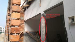

Need your advices for structure issue.

if u're thinking to remove the pillar, check first if there got any beam juz above the pillar and at the top.
judge the strength by measuring thickness of the beam supporting and beam holding.
if its sufficient then u can remove the supporting pillar
if not its better not to remove it coz it may cause the structure to collapsed in future.

the thickness of the beam is the whole thing on top of the pillar. i dunno enough or not.

With limited information, I would be wary with any advice given.
You should provide at least the following info for anyone to give a general advise.
1. What are you planning to place on top of the beam?
2. What is the spacing between the next 2 supporting columns on the same beam?

QUOTE(kh8668 @ Aug 17 2011, 09:37 PM)
i doubt that... u can try to hack a smal area above the pillar to the top till the bricks are visible enuf
then u will see how thick the beam supporting n beam holding
in between em is juz wall of brick

haha..ya i know very hard for someone to comment here.
this is for kitchen extension, but got this pillar block in the middle. so ask if anyone know it is safe to hack it off?
the distance from the wall to pillar about 11 ft and then another 5ft to toilet wall as shown on pic.

There is a reason for the pillar build there. To support the roof weight.
Is better build one on the side, not too far toward the end, maybe 5 feet, enough to open the door. Or on the end on your extension, build 2 pillar, add two beam from the pillar to support it. You need to connect the BRC
What every is it, is your own house, better consult structure engineer.
I'll pay bit more for the comfort of safety.

hack a very lil bit of the column... if u see a rebar/steel.. that means the collumn is there for a purposed..to support load from above.... my 2cent advice, do not remove it...because in engineering..everything is there for a purpose...
if there is no rebar...most likely the said collumn is only a stiffener to hold the existing brick walls ...

Looking at the picture, the thickness of the pillar it should be a load bearing. If remove, and coincident your neighbor knock the side pillar... PiPa... all fall.

on top of it are two toilets.
it seems that the beam support the two toilets slab, and I dunno whether the pillar is a must to support the beam or can just remove it..

lol..the contractor is not recommending to hack any part of the beam but this one as per requested by house owner.
my concern is whether the pillar can be removed? i can just let the beam as is where is basic but the pillar... .... icon_question.gif

dont do like ur neighbour did... the collumn is a load bearing collumn...to be safe, do not demolish it... although above is "just" a toilet...but load distribution of all the 2nd floor and structure integrity works like a net... take a chunk off...and the structure is compromised...

pillar can be removed, but must make sure first the beam strong enuf and can support the loads

Column acts like our feet with sole purpose transferring load to the ground & foundation..U have your house drawings? might as well study it first. U don't want your house to collapse.

opps..i only have architectural floor plan but not structure floor plan.

Now people are just rebuilding for the sake of "nice". Safety is really the main thing before doing anything. Please consult engineer.
