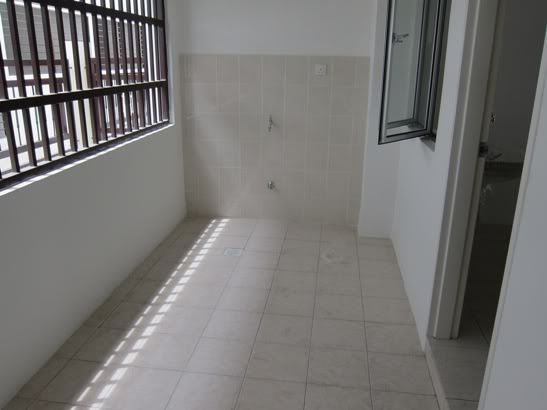

My house has a yard like this which i'm going to use as laundry area. As I don't want rain splashing in making the grille rust and rust stain on the wall later, I wish to add normal swing window to it. What will be the estimated cost? Its size is about 11'4"x3'8". Beside it, there's a grille door, what should I do with it to waterproof the grille door area? These grilles came originally with the house. Thanks.

Sorry, gave wrong height just now. It's 3'8" height not 4'8". Thank you kuchingfight and phoenix69. So, judging by the pricing u alll gave, I should estimate around 1200 for windows. How about workmanship?I am planning to let them install right on top of the cement so hopefully can lessen hacking and cement works, possible? I have an alarm sensor there, so donno will kena its wiring o not.

QUOTE(weikee @ Aug 14 2011, 10:45 AM)
Depend the current area have enough sitting for the aluminum, if not you may need to hack the grill out, or maybe add some brick/concrete to let the windows sit on.
Usually calculation is round up. 3.5 or 3.8 use 4', 4'8" use 5'
I'll take a picture of the extra cement area outside the grille and upload tml plus measurement.
QUOTE(kelvyn @ Aug 14 2011, 10:49 AM)
Few things that you need to consider.
1. Is the laundry area located on the ground floor (landed property) or in a condo (above ground floor)?
Ground floor landed property.
If yours is on the ground floor, they can easily install from the outside. Else they will have to take out the grill to be able to install the window if your place is not on ground floor.
2. Is the plastering around the grille opening perfectly square? Cos the window will be square and if the present opening is not, then there will be gaps at some of the edges.
If you mean the edges whether comes up to a square, I believe yes. But if mean whether the cement area if perfectly 90 degrees to the grilles, I think no. It's slightly slanted. Better if I take a pic tomorrow.
3. Normally the windows frame will be installed with some portion embedded in the plastering. Avoid water seepage and also there will not be any gaps between the frame and plaster.
As for your concern about the alarm wiring. Mostly the alarm wiring are running on the inside and connected to the grille. You will be installing the window on the outside. So, the chances of damaging the wiring is very slim.
Which means as long as they don't remove grille or hack the inside, should be okay right?
