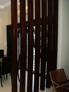

You may try having something like these to secure them in position.
Alternatively, you could have the built-up columns instead of solid chengai. This way, the fastening into the floor and beam will be conceal.

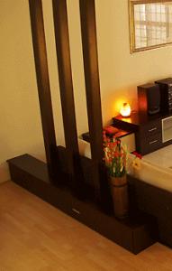

what can i think if u not wanted to see L brackets, is to use smaller solid wood eg size of 25mm x 12mm to fixed that to floor and ceiling with nail like the picture. then color it to same is your solid wood, will look batter i guess.
