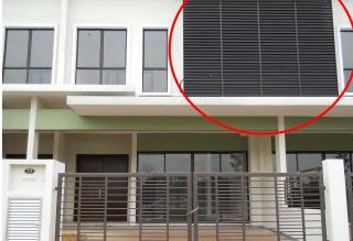

Hi friends,
Please refer to the below circled part in the picture...
Anyone please tell me what is this thing made of? aluminium?
Any purpose? just for design and looks modern?
Expensive? If want to ask the price, where should I look for?
thanks...

look like aircon compressor closet to me.

Yes its is aluminium.We call it sun shade and its work for 2 purpose
1st sun shading of cos
2nd as curtain.
Not all kind of house can be install with this type aluminium its depend on the house situation much.This kind of shading comes in various type and dont expect the price would be cheap as it require a high labour cost.

alum, metal or what ever material is up to you as far as u willing to pay for it
but in the market usually its made of aluminium
this 1 the above estimated size 4m x 4m
aluminium powder coated
and it will cost around RM 2-3k or even more depend on thickness & specification & quantity ordered
beside for sunshade, curtain, looks
it can also use to cover up your aircon compressor unit
based on the photo there, that area might be a aircon ledge / vent

normally to use aluminium would be great. But not this colour la, silver colour would be great.
and do in sliding type can open when u need light or view.......

The picture shows Serena at Bandar Puteri...
The main purpose of that is to prevent people from climbing into the house via the bathroom window, as it is built really close to the wall. Of course, sun shades too... although i doubt u can hide a compressor there, due to space constrains...

That's aluminum louvres.. Used a facade decoration + ventilation.. Price is approximate 450-600 per m2 depending on spec..
