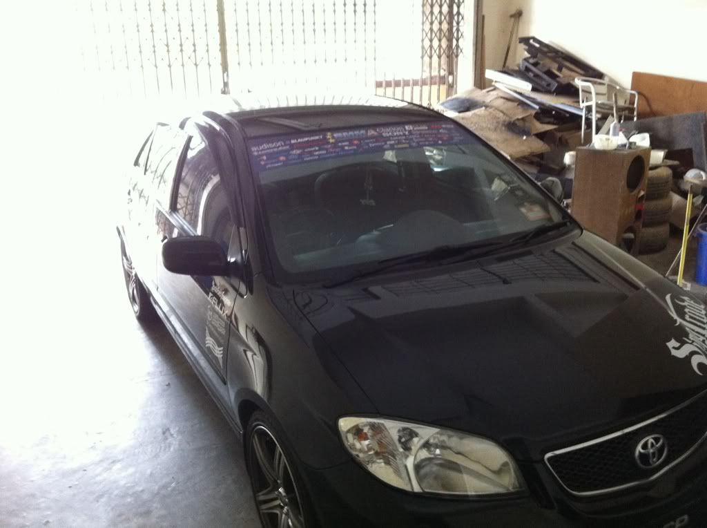

Just audited this black vios... (rushing, gf keep calling tongue.gif )
using alpine w502 + H800 processor
Flux third level component set and rockford amp...
To my surprise, although the equipments is not top notch
but with thorough and careful installation & tuning, its simply amazed me
As usual, Flux speaker always sound so crispy, bright yet not harsh.
Not a fans of current RF, but this time they didnt fail my expectation... carry out the job quite well
The accurate staging and dept, enhance the pleasure while listening music in car
Tonality are well control, whether yelling/shouting/murmuring...
Its still clear and not ear piercing... apparently, great job on crossover/time alignment setting
hence neither cancellation nor peak issue happen in this ride
The ICE system was initially done in singapore
then passed over to Famous Audio (JB) for another round of touch up
They strengthen the installation, with new handcrafted a-pillar and tuning...
comes up with remarkable result...
Last but not least, Icer don't just spend whole budget on hi-end stuff
but kedekut on installation, as equipment only occupy 30% of your overall performance
The remaining 70% are from installation + tuning...
with proper tuning and install, even entry level ice can sound great
vice versa, 100k equipment can sound like shit (audited many example actually tongue.gif )

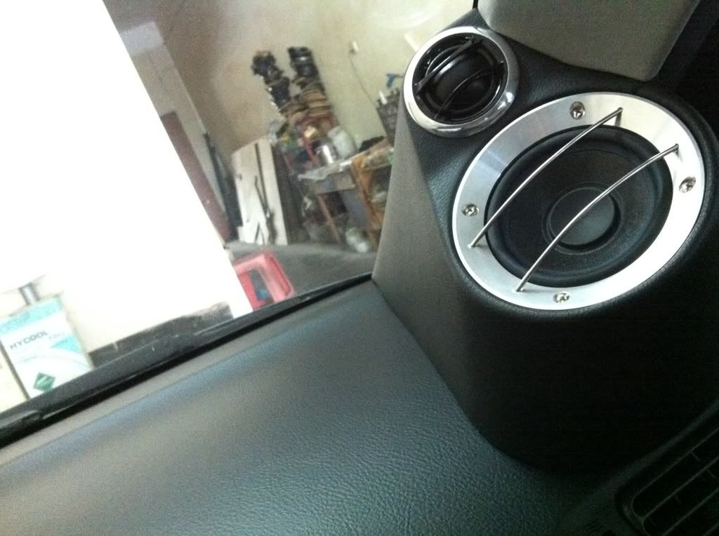

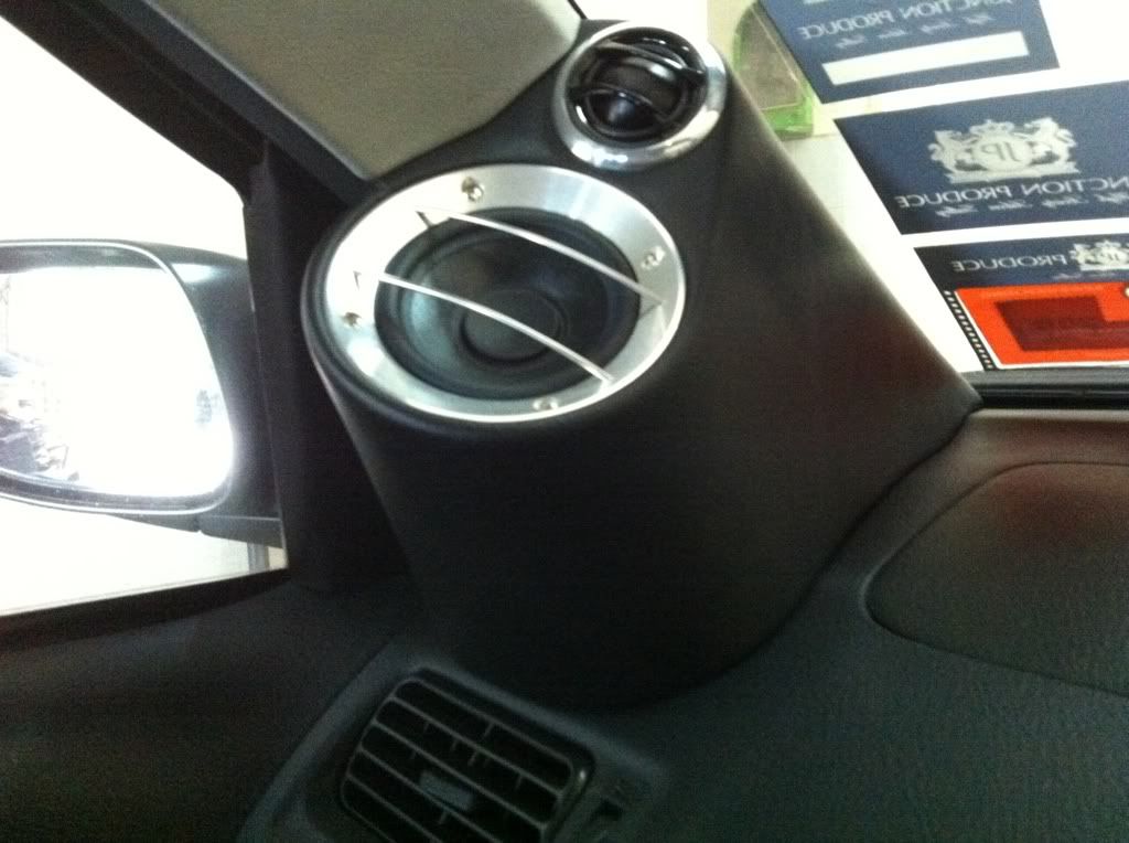

Well, most of the people knows that RF's quality are going down to drain for the recent models.
2nd, the speakers shoot the wrong angle, which will affect the overall performance also.
Each speakers got different sweetest spot depending on the cabin size(internal volume), placement and the enclosure made for them....
I may get a set of Focal Be and with such placement, I will get rubbish results....
TSzacisme
post Jun 17 2011, 08:56 AM
Joined: Jun 2011
QUOTE(kyheng @ Jun 17 2011, 07:56 AM)
Bro, i can assure you this is not wrong angle, and it will not affect overall performance biggrin.gif
In fact, its a solution to enhance the staging width and depth, good for car with shallow dashboard
Placement and enclosure volume are calculated before making it...
The keypoint here is "balance" thats why performance was not affected.
Don't straight away jump to the conclusion while seeing off axis design. smile.gif
You can definitely get Focal BE, and with such placement,you might get rubbish result
if not tuning it properly, or don't understand the overall concept...
but with proper tuning and power (BE is good, but big eater) it will be very nice
sigh...

Well, there's difference on cone or dome mid..... This is what I can say...... Cone type is best for on axis not off axis......
TSzacisme
post Jun 17 2011, 10:08 AM
Joined: Jun 2011
QUOTE(kyheng @ Jun 17 2011, 09:37 AM)
There is no "best" in car environment with the limitations and flaws, in home audio maybe~

hehehe... there is a reason for that...
nobody likes big pillar, but it has a huge advantage...
if it doesnt, tuner won't bother to make such a big volume, waste money & time
Added on June 17, 2011, 4:40 pm
QUOTE(kyheng @ Jun 17 2011, 11:22 AM)
If i come down, I sure will let you know....
I prefer dome because it is omnidirection..... That's the advantage(and disadvantage) as you need to consider reflections. So placement will be bigger challange....
based on my puny exp...
its easier for dome mid to sound normal, as its only facing directional issue
but doesn't need big enclosure volume...
however lack of lower extension, can't cross low
cone mid facing more hassle
not only reflect issue, also need bigger volume to perform
after comparing two types of speaker
This post has been edited by zacisme: Jun 17 2011, 04:40 PM
