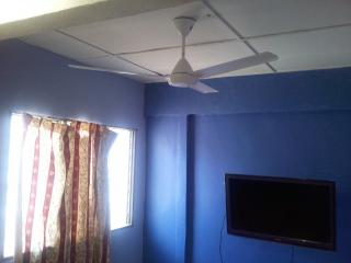

i live in double storey terrace house.both floor equipped with a ceiling fan
currently im trying to turn my room at 2nd floor into a multimedia video game movie room.
i install kdk ceiling fan.
but the heat is unbearable,especially noon and also nite.
i cant afford to install air cond,and currently my house electric bill is still free,lol.
are there any way?kungfu? to make my 2nd floor as cold as my 1st floor?
exhaust fan? ventilation fan?will it work?
someone told me to put polisterine on the attic to stop the heat from coming down.
the logic is jus like polisterine box are being used to kept ice from melting.
will it work?
my room

I believe it's hot because one of the wall face sunlight during afternoon to evening. Heat trap in the wall will be released at night.
Have ventilation, use a suction fan to suck out hot air. Ventilation fan does not use much electric as air con.
if you have money to invest. The best bet will be an insulator. I got a contractor to build this some time ago.
On the wall that face sun light, they assembled a frame consisting of made of wood laid vertically. aluminium can be use as well. In the empty spaces, heat insulator can be placed. if not leave empty, air also can act as an insulator. Before you put up the wooded / gypsum / artificial concrete. You can have additional heat reflector pasted at the board facing inside to reflect heat.
Last time i did not do both heat reflector / physical insulator. Still the temperature reduce to an acceptable range.
The greenest way. Grow a tree to block of the afternoon sunlight.
If you were to put aircond do not put at the wall facing the afternoon sunlight. avoid placing the compressor at the same wall too,
Good luck!

It shows that your roof is badly insulated. Your condition is same as mine, mine is three storey house, The top floor is super hot in the afternoon, the living room is probably 2-3c colder than the top floor. You can practically feel the difference in temperature, downstairs and upstairs. It's like walking into a sauna room in the afternoon.

can try install a turbine ventilator..
to extract the heat out from the space between ur ceiling and roof
or install a ceiling ventilation fan to remove the warm air from the room and keep a circulation of air to keep the temp down..
air from bottom house raise up due to the ceiling ventilation fan and the air is extracted to the ceiling and the turbine ventilator take the hot air out from the attic/space between ceiling and roof...
u want better install thermal insulation material.. and if got some extra money to spend around wash and repaint the roof to white/silver shade..

Added on June 7, 2011, 7:47 pmThe room is hot bcos the heat transmit from roof and trap in ceiling, when you on the ceiling fan, it puss the hot air downwards. Also, there are more heat come in from the window if your window is facing west.
Thermal insulation on the ceiling + tint on window. Open window when the outdoor ambient is cooler for natural ventilation.

I think akmis is 100% correct. Heat is from your side wall, ceiling is not so bad assuming you have concrete roof tile.
Insulate yr wall, outside cannot ( for link terrace ) then do inside. Not much choice other than AC.
