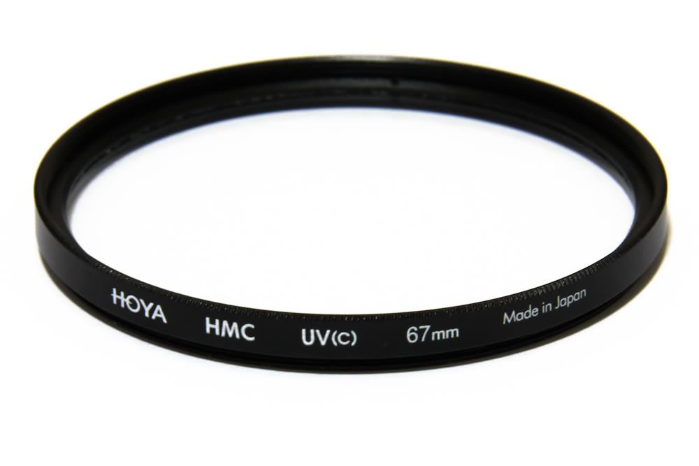

Filters, what are the uses of filter?
Today's filter uses are quiet different from the old film days. the film was sensitive to UV, hence people uses UV filter for their film camera. Today, filters are commonly used to protect your lens. Filter are something i always advise my friend who buys a new lens, to buy filter together, since you have just brought a lens, surely you can haggle more with the shop for the filter. or haggle for free filter~ (that way, you dont have to come to lowyat.net a week later and ask where or which filter is best to get.... or skim on finding the cheapest filter in penang when u stay at johor...and get back fired. sorry for my sarcasm.)
Digital sensor today will not benefit what-so-ever from an UV filter, because today's Digital Camera comes with a Low Pass (Anti Aliasing) filter, that have UV and IR filtering behavior so that the digital sensor wont pick up any UV/IR spectrum/color. So its noticeable that, china made/imitation/cheap filter would simply print "UV" filter and market it as its use for filtering UV. oppose to Branded filter who spend money in research a proper coating, will sell their filter as Multi Coating *MC filters (which will have UV coating to protect ur eye from seeing through the OVF. some will brand it as UV-MC.) to Enhance the color for digital sensor pickup, and reduction of color aberration, Flare and Ghosting effect
*add-on, was told that UV filter will reduce CA in photo, confirmed, but, higher end camera (crop flagship and FF series) has built in "CA" reduction in the AI-CHIP (digic/expeed/bionz) base on their original lens profile.
Now, Why do we need a Filter?
to me, my answer is simple, i shoot in a dirty environment, dust, oil, water, wine, ice cream gets on my lens, then i would use any available cloth and wipe it. (i bet u wont use lenspen to wipe icecream off the lens!) so, i would risking getting my expensive lens first/front optic/element to scratches!. so what happens is, i get a filter, put it in front, if it get dirty, just wipe it, if it get scratch badly, i just change a new filter, anyway, the filter is around fraction of the lens price. so basically it prevent risking your lens's optic from scratch during cleaning/wiping.
it is cheaper to replace a filter then to replace a lens.
so, if you are the careless, or working in environment that dirt/moist get to ur lens often, get a filter so you can just wipe it off without worry you would damage the lens's coating.
*was told canon L lens require a filter to complete the Weather Sealing, need confirmation on this.

Anyone can tell me whether this is orginal or fake Hoya HMC filter? Bought this from one of the shop in digital mall last month.

Ugh... bought a new Hoya HMC UV filter 67mm and only noticed there were small bits of coating marks on the glass when i reached home.
Anyone with similar experience on how this affects image quality?

well...
1. is the coating mark in dead center of the filter?
2. do you often shoot at above F5.6?
if both answer is No, then it is not an issue.
if either one is Yes, then you 'might' notice softness or marks on your photo.

1. Not in dead center, but there are some bits (less than 5mm) here and there spread out..
2. Yes especially landscape/scenery shots.
Arggg I didn't see any of those marks at the shop when inspecting. This is frustrating...

aisks... maybe, Maybe u can return to the shop with receipt ask them why after few days the coating chip off like that. see if they willing to swap a new one for u

post Nov 4 2016, 07:01 PM
10K Club
Moderator
10,308 posts
Recently purchased a Hoya HMC filter... but I see there are many fine dots on the filter itself. Is it a defect?
Tried to clean it using microfiber cloth, but still can't remove it.

QUOTE(HMMaster @ Nov 4 2016, 07:01 PM)
Quite common with Hoya UV filters, I had a few and also exchanged a few but am never happy with their quality. Stopped using Hoya from then on...
HMMaster
post Nov 4 2016, 09:08 PM
10K Club
Moderator
10,308 posts
QUOTE(Lego Warfare @ Nov 4 2016, 07:58 PM)
