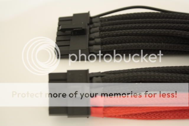

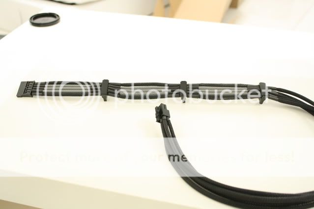

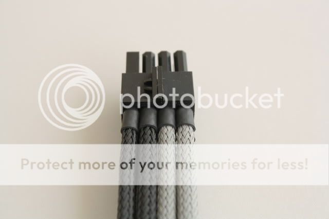

This is the result of 1k sleeving.
My client was so worry about his cable, since the result was totally not convicing.

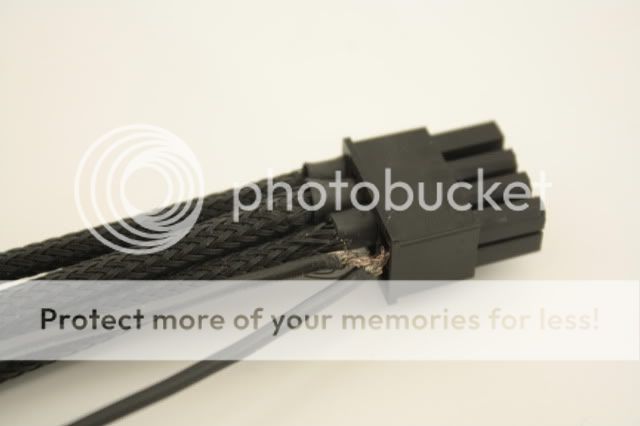

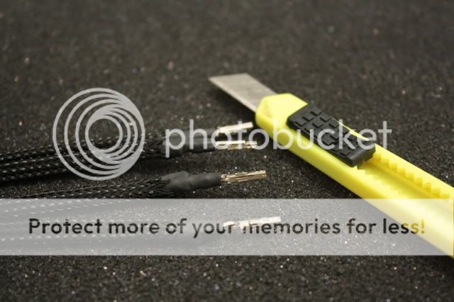

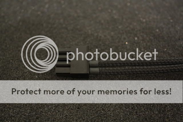

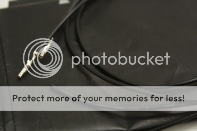

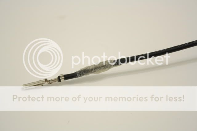

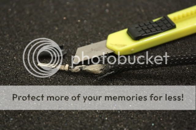

And i start to checking the wire 1 by 1, surprisingly i found this. rclxub.gif

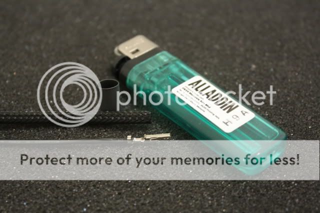

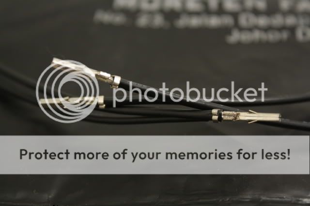

So i do the replacement wire for him, luckily i got all the stuff on hand. icon_rolleyes.gif

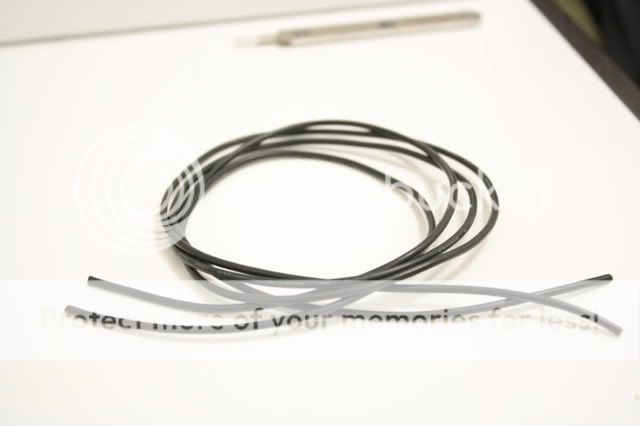

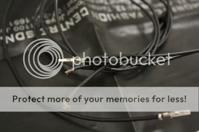

Cut 2 wire into require length.

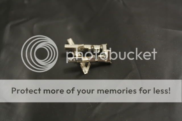

The crimp contact.
And the result.

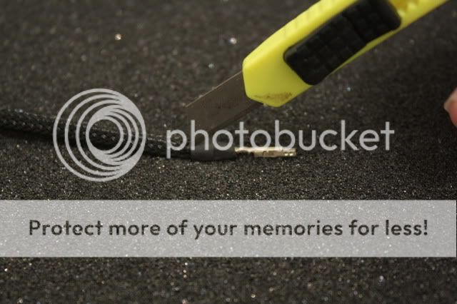

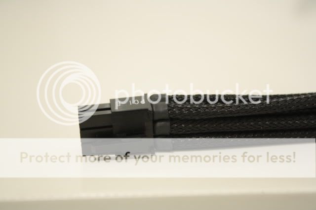

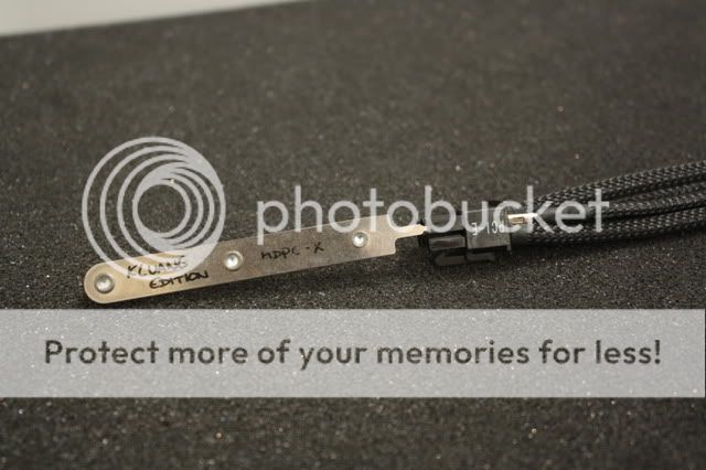

After the wire replacement i start to take out the wire from the connector using my MDPC pin remover "Kluang edition" haha.
I'm going to cut all the heatshrink out and re-sleeve the wire, the following picture below might make you feel uncomfortable. tongue.gif

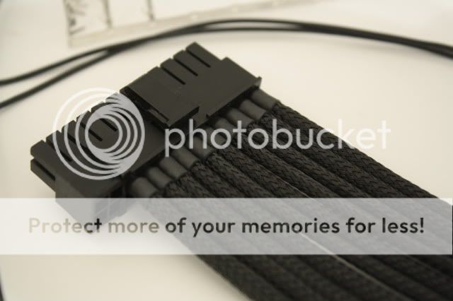

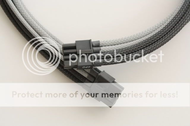

Another surprise for me and my client.
Guess what, its double sided tape on the wire.

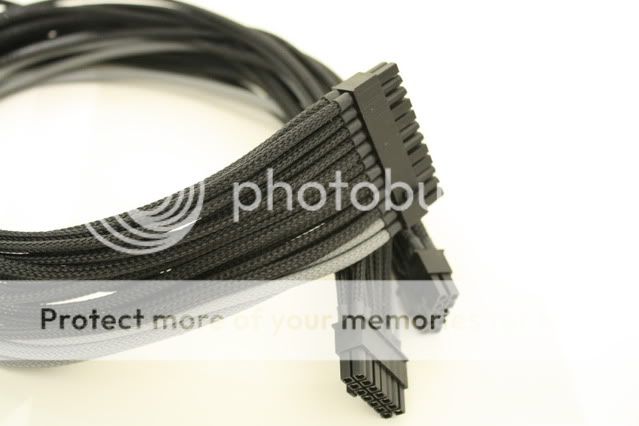

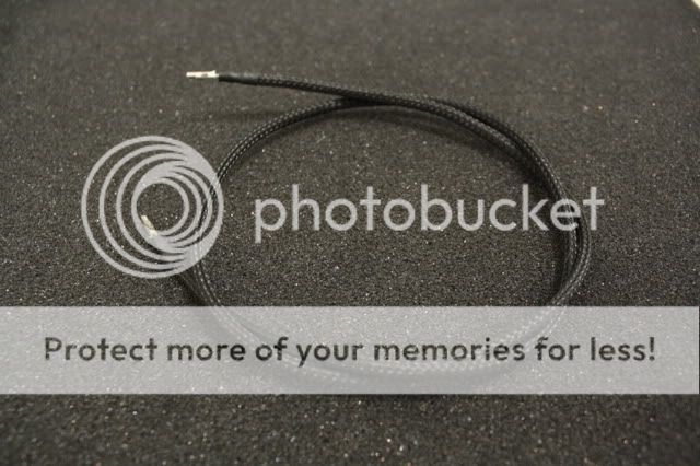

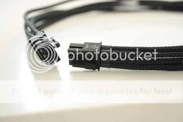

New heatshrink and black sleeve had been cut.
1st attempt on my sleeving.
2 wire able to done today, because use too much time on cleaning the double sided tape. doh.gif

That fella just force/push the wire back into the pin molex.

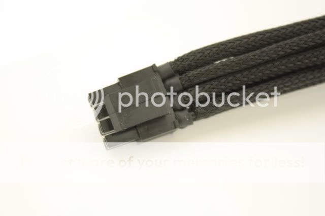

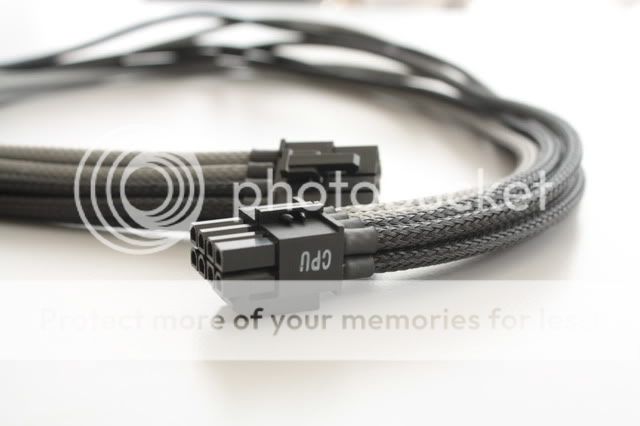

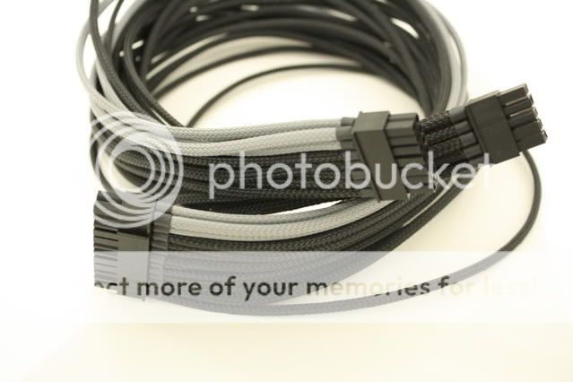

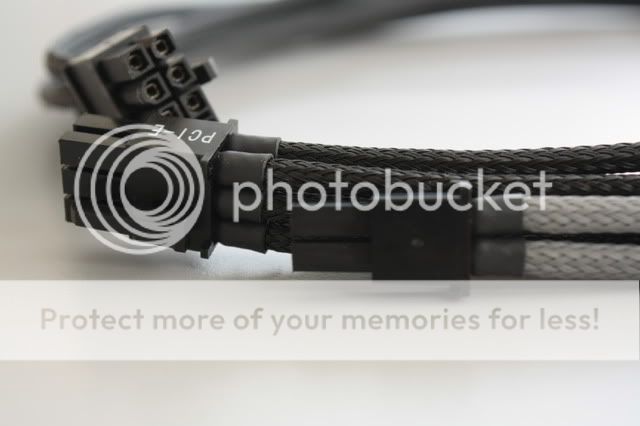

Hi guys, some result to show here.
It just a very short update, cant really do it any faster.
I knew my progress are way too slow, but patience is the essential for sleeving ha. laugh.gif

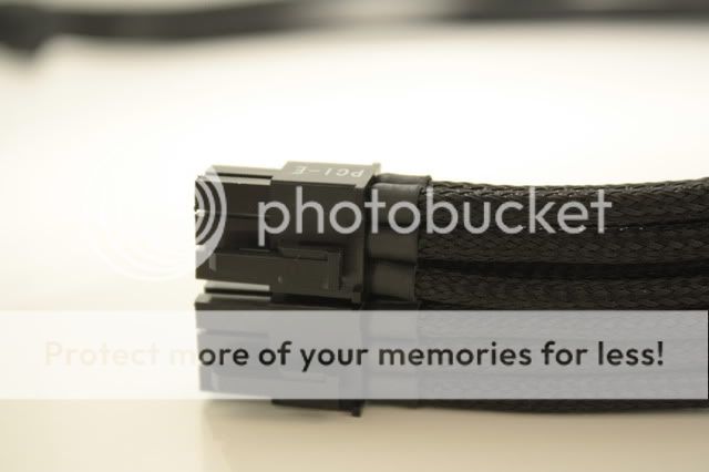

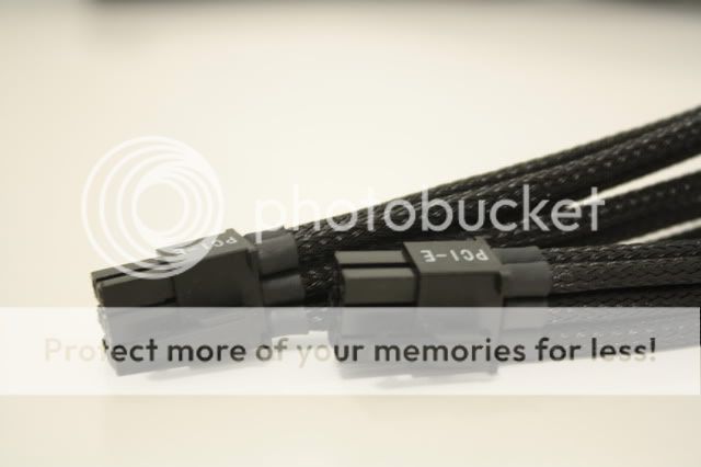

Here is the how it looks like.
It still not MDPC level, but its the best i could do.
