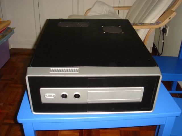

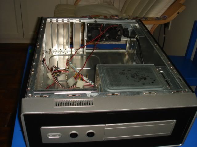

I got this case quite sometime ago, prolly a year or 2, from someone in the Garage Sale.

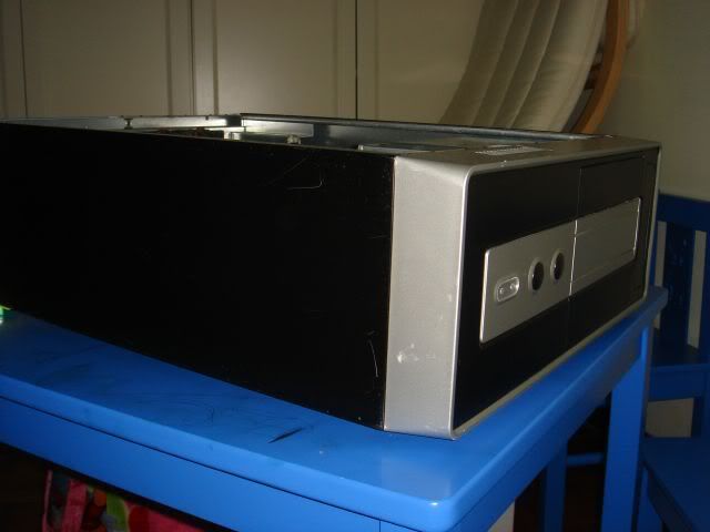

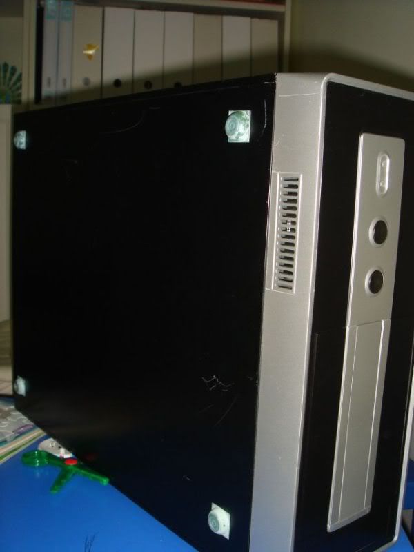

When I got it, this is how it looked like:
(BEFORE)
I was not happy with the front panel, but the size was alright for a HTPC.
Started to "redesign" the outlook of the casing, and decided to go for the "plain-jane" power amp look.
The Project commenced with the stripping of the whole casing to separate pieces, and drilling out the rivets.
After that, procrastination took over and I junked the whole lot into the storeroom. Sadly, it collected dust, and nothing was done there on.

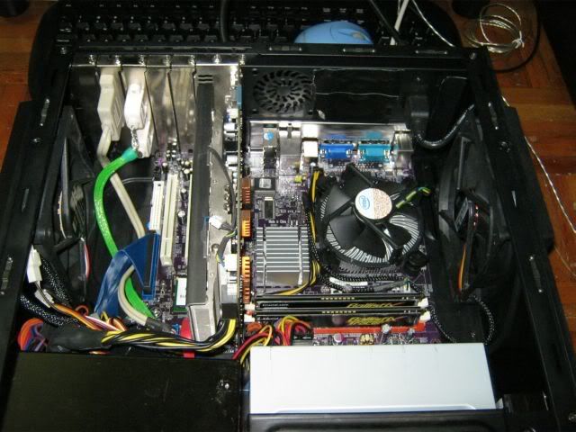

Ingredients that maketh' mah HTPC:
G31 mobo
E3300 proc
2gb rams
Modded Huntkey PSU - dissembled the casing and drilled more holes on the PSU chassis for "better" cooling.
Illuminated power switch
1TB HDD
HD5770 Hawk GPU
a handful allen capscrews to bolt the front place to casing
2 units of 12cm fan filters

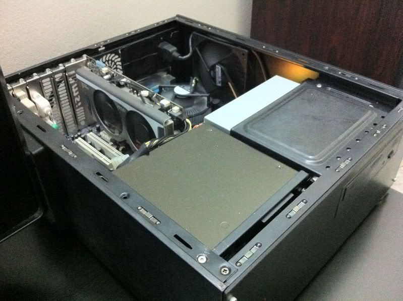

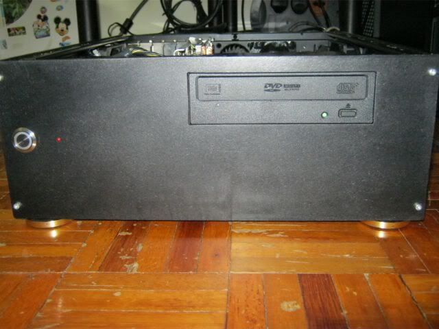

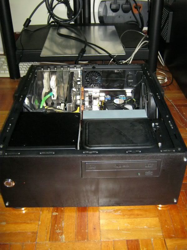

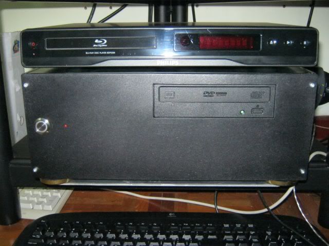

First thing done was cutting of an alu plate to fit the front, and slowly cut out holes for the dvd drive. Holes were cut for the power switch and power LED as well.

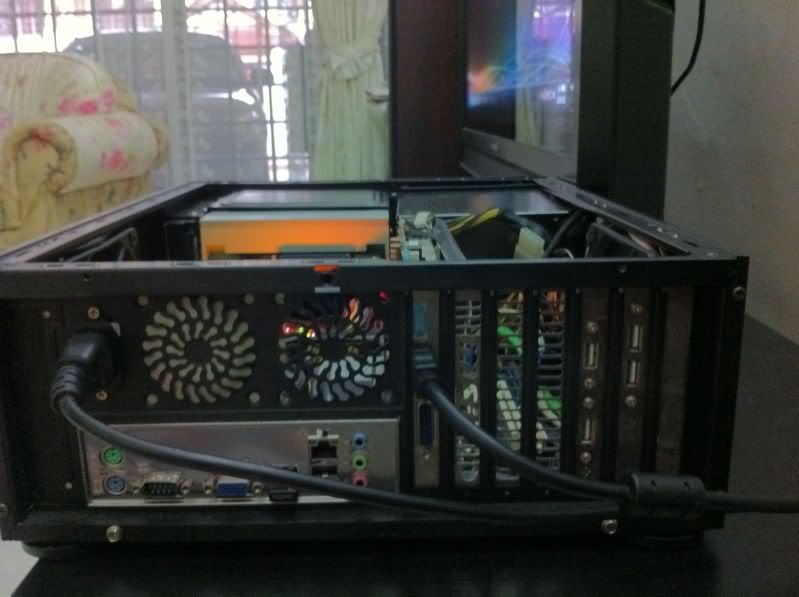

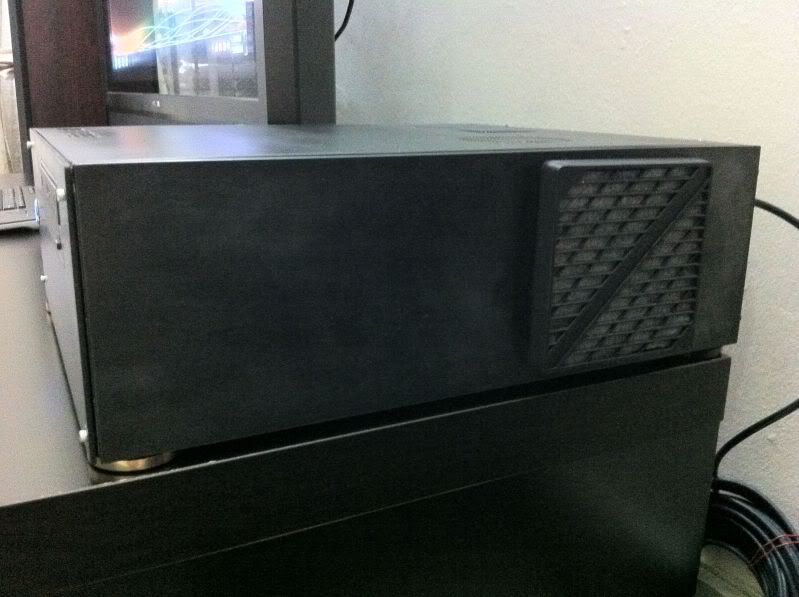

Both sides of the chassis were cut to fit 2 units of 12cm fans.
After all that cutting and grinding and smoothing, sent the complete casing to a friend(who's working in some metal shop) to get a new skin colour, which is black biggrin.gif . The front aluminium plate was anodized while the other steel parts were blackened.
All the stuff were put together a coupla days before CNY 2011. The front panel had a nice finishing....but wasn't too happy with the colour on the steel chassis. Too late to do anything, but to put everything together.
Sorry, no pics during the build...only got pics after completion... biggrin.gif

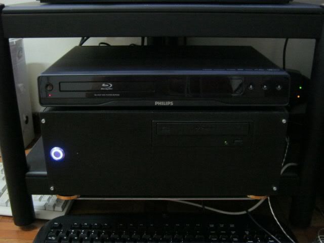

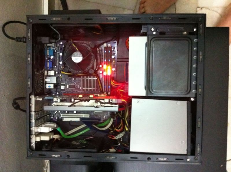

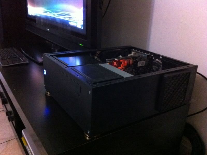

(AFTER)
Put together with my bluray player. seems like the width of the bluray player is similar with the case... thumbup.gif

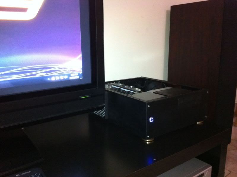

Powered up...
Currently, I don't have wireless keyboard+mouse and a nice multimedia remote...was thinking of getting a Rapoo 2900 or something similar....but it will have to wait...
Recently added another USB extension hub at the rear...to have more USBs for "future proofing" whistling.gif

That's what my current messy HTPC setup looks like now...

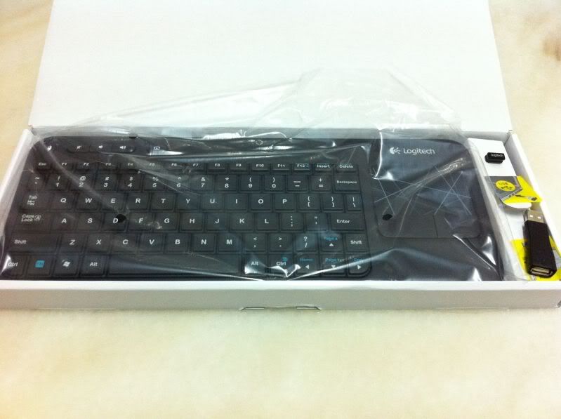

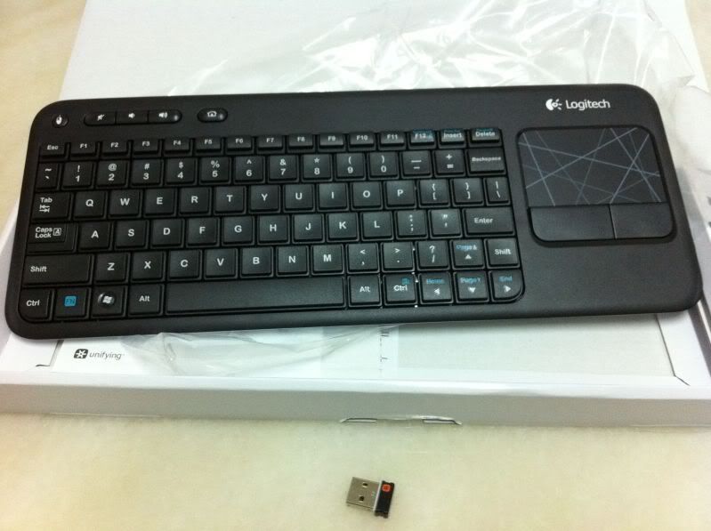

Got this keyboard(Logitech K400) with built-in touchpad from LingLoong in Garage thread.
Comments on the keyboard:
The size of the keyboard is just nice. Very handy. Comes with a tiny receiver, and an extension, which I didn't use.
The touchpad placement was superb. The keys are thicker as well...sort of like "raised" hence enabling easier pressing of keys.
General build of the keyboard is OK. After using it for awhile for surfing and watching movies, I felt the keyboard is built specifically for HTPC usage, which is SUPER. Just what I needed.
The price is also very nice, and coming from Logitech, I would prolly get another 1 unit and keep. biggrin.gif

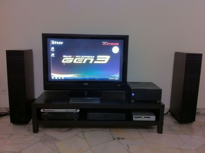

Anyways, back to the HTPC build. Recently took part in the A.P.E.S/MSI competition(which ends tonight), and had some pics taken.
Reposting the pics, as posted for the competition.
Current amplification hardware:
Amplifier: Rotel RA 970BX
Speakers: TDL RTL3
Cables: Cable Talk3 bi-wiring
At the moment, it's not a 5.1 system/surround....only 2.0 system. No budget to change to AV amp.
Well...the journey continues...
Cheers, and thanks for dropping by.
