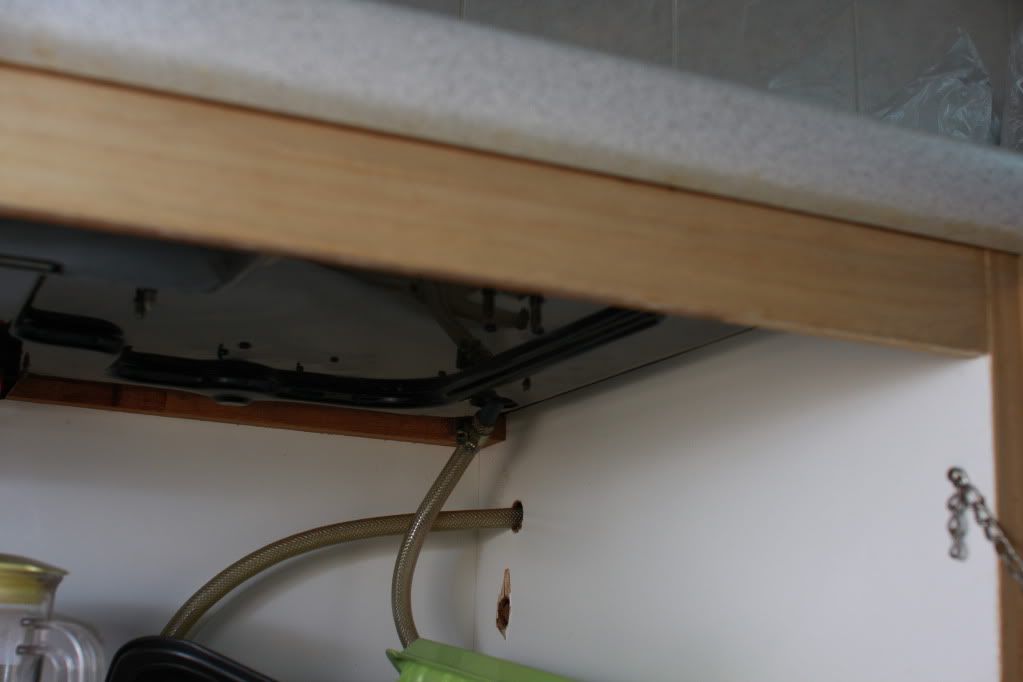

I have this hob over a period and now there is few problems with this hob. Sometimes when I light it up, there will be burst. And the fire produces are actually much more smaller compare to last time. So I want to change for a new one. Prefer 3 burners, but 2 will do as well, budget is below RM1000, or around RM1000,
I had asked some of the forumers here but they seem like do not have any solution for my case since there are quite a few problem with my dimension and others.
I am eying on the Electrolux 7432S but I am not sure whether the dimension will do or not. Since the outer dimension is 760 x 460 and cut out dimension is 732 x 57 x 421, which means that there will be only 3 cm on the side and 1 cm for the front and back to support.
Someone who has experienced with this type of problem or are good in this please help me out, really appreciate it since I do not know much about this.
This is the dimension I got for my current gas hob (Faber FGH 33B/76)
Cut out dim: 730x450
Outer dim: 790x510
Thank you very much!

the flame is small becos you didn't clean it, try to use needle to clean the gas vents , try to wash it and dry it 1st.
Also if you really need to change a new hob, what i saw in your pic, either is you need to get a new one which size is bigger then the old one, and ask the shop to do you a favor to enlarge the hole.
Do not get hob tat is smaller then you existing one.
