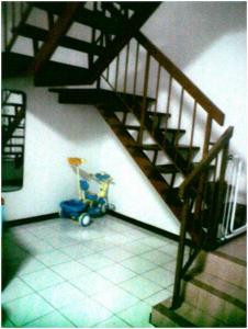

hi guys,
need some advices about to close the stairs to become store room. (don't know what is the correct term.... tongue.gif )
a) so how much will it cost & how it normally calculated? per sqft? per pieces?
b) any suggestion on how to do it (any attached pics are most welcome...)
c) any recommendation of contractors/carpenter at kajang/bangi area?
thanks for any advices...
please refer below picture.
Attached Image Attached Image

I think the way of doing that is to remove the whole stair and re-construct by using concrete. then close the bottom of stiarcase by brick or partition to create a store room. This was a "big project" and i guess the cost must be around 10k to 20k depent on material using.

Another way is for the contractor to build plaster walls around it.
An experienced one will know how to do it without demolishing and reconstruct the stairs which will cost a bomb.

use drywall method...aka partition for the store, close up the staircase riser with matching timber plank, less than 3k i guess smile.gif

wow...quite big project...i'm afraid that my budget should less than that...i would say RM5k only...
QUOTE(skng03 @ Jan 6 2011, 12:11 AM)
hmm...interesting...but i wonder RM3k is it for the whole staircase (U shape as per picture attached) or for one level/slope only...?

Do you want to use the existing stairs? If yes probably will need plaster partition or wooden laminate partition. Else demolish the whole stairs and use concrete.

already give rough figures to 2-3 contractors (who done kitchen cabinet) but they said normally expensive and hard to be done...i don't know, maybe they don't want to do that kind of jobs... hmm.gif ...but still didn't invite them to my house yet, yes...maybe i should..

yes i want to remain the existing stairs...

to me, is really dificult to do by partition box up, because the worker need to fix the wood pcs by pcs to each step of the stair, and have to make sure your staircase is not (movable), usually staircase like yours when u go up and down, the metal support will have a bit shaking feeling, that may cause the plaster between partition and your staircase have a (crack line), unless u know about this and you done mind.
So, the best and nicer way to do for me is remove the staircase and build a new 1 by cement

I really think that you should look for a suitable contractor to do this work. Anything is doable, it just depends if the contractor want to do or not. At times they might just be too lazy to do so much of work to get it done.
QUOTE(Eleganz Concept @ Jan 7 2011, 09:13 AM)
Fatin's staircase looks really nice, i think by removing and doing a new cemented stairs will make it look so common. We don't get much of this type of stairs anymore!
Actually the work is not difficult, only its cumbersome, you need to do up the frame/shell piece by piece, the store support doesn't have to depend on staircase, instead they can get the support from the wall n floor, just leave small gap between the staircase n the store room will be good enough. To closed up the whole frame you can use those ply, nailed them piece by piece after all the size are measured n cut. This is not messy job,only it take up a lot of time.

I tried to do the same thing last time. The contractor told me, he needed to put a tiang besi, from ceiling to floor to act as a support pillar for the wood. Anyway, by the way he talked, it didn't look that difficult for him.
Anyway, I ended up making a new concrete stair.. Roughly around 5k.

I've done my one, you don't need any tiang besi at all.

kayu + papan rm500.
besi rm 500
labour for form work & besi 2 worker x 4 day x rm70/day = 560
concrete 2m3 + labour = 600
cement, sand,tiles + labour = 2000
total 4160
