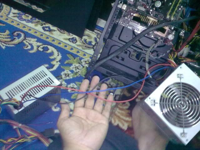

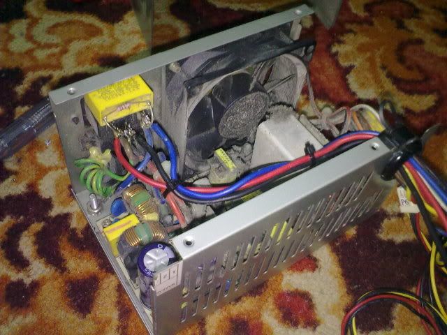

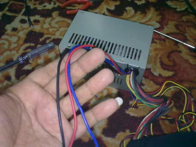

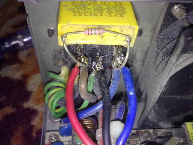

1st step is, for powering the PSu. Open up PSU housing, using 3 different colour of power wire in desire length...
solder using soldering iron like this...do this step on the both psu 240v power input port. please take note to solder
on the same port...on this step the different colour of wire would help...
power input 240v done, take from 600watt PSU to 200watt 2nd PSU.
p/s: you should not do this mods if your PSU had 240v output port (usually on old type PSU). only need
power cable with male/female soket like this...

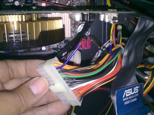

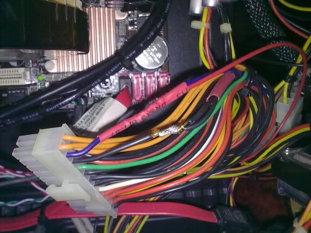

now, the 2nd part is to mods relay, so the 2nd PSU will only turn ON if the main PSU is ON by mobo...
let see this diagram of the ATX soket pin...you will see the two pin using
for connected to the relay...(mark as no.14 - PS_ON and no.15 - COM)
Pin no.14 ATX socket will be connected to Pin no.30 on the relay as diagram
below. See bottom of relay to find the number of relay pin.
Pin no.15 on ATX socket connected to pin no. 87 on the relay.

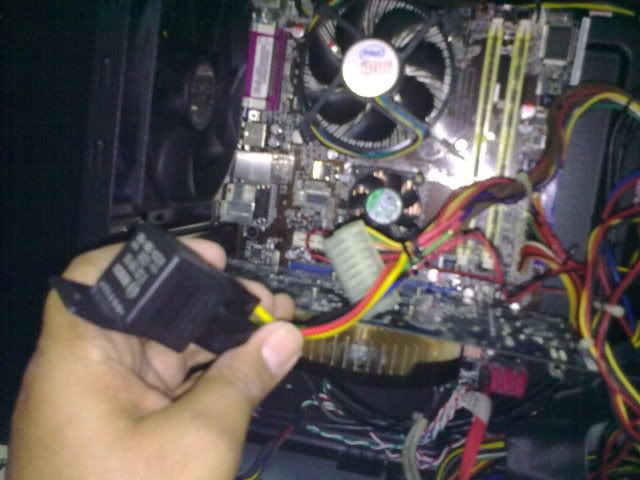

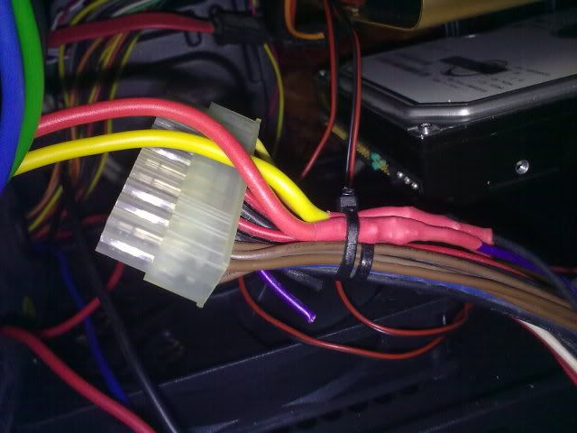

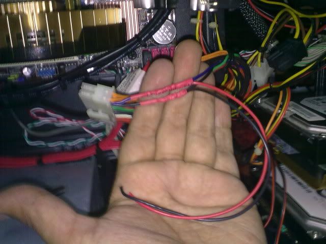

i just cut the wire of no.14 and 15 at the ATX and connect to relay wire directly like this
After that, u need the trigger of 12v for powering the relay from the main ATX on the mobo.
i just loop two wires from there, that was no.12 and 13 on the mobo's ATX...
no.12 on the ATX go to no.85 on the relay pin..(refer to relay diagram above)
no.13 on the ATX go to no.86 on the relay pin....solder them all...
done...

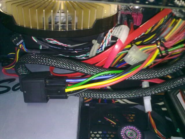

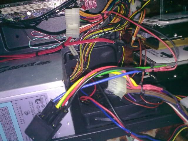

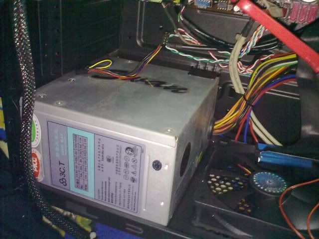

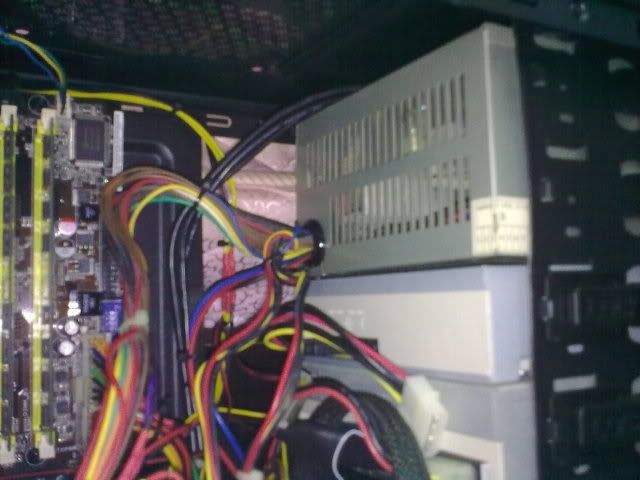

almost done...the relay...you should place this relay in proper...
i have no time to think about it yet...just left the relay like that lol

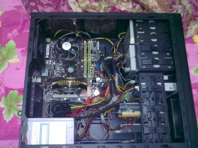

the 2nd PSU...i place it on the bottom free space over my odd rack...tight to get in lol...
done, now u can use the 2nd PSU 12v socket to power up you additional fan, hdd etc...
power up the computer and check wether everything is working or not... cool2.gif DONE.
my CPU look messy rclxub.gif with no neat cabling management...i should manage my cable
as well...looking for time to do that...plan for cable sleeving next time...adioss... whistling.gif

my PSU max out for 12v is 10A, im using relay 30A...so i think its save for relay...
many ppl do this double PSU, but only trigger by manual swith to ATX socket
no.14 and 15 there...mine is auto trigger using relay...
i do heard my fren do the double PSU long time ago when he used to have
many unit of HDD...no problem so far...running ok on my desktop now..

basically, this mods is safe...
u only make a connection for power, using power cable. if your PSU have input/ouput port for 240v as i mention, no need soldering for 240v power.
then u only dealing with 12v power output...using to activate 12v relay
taken from main ATX PSU power as per diagram...12v only...no harm...
relay is trigger the 2nd PSU by shortage the PS_ON to COM pin at the 2nd
PSU ATX socket...thats all...i dont think this is harmfull...
main PSU running as usual, 2nd PSU running by trigger swith from relay
and got power 240v from direct AC port from main PSU...
when the main PSU swithed off, the relay goes off and the 2nd PSU goes off too...
This post has been edited by joefbi: Dec 5 2010, 04:42 PM

nothing harm...
the output is 12v maa...not 120v...heheh
only use 2nd PSU to powering all the fan and ODD+floppy...
main board, GPU and 1st HDD stay powered by 1st PSU...
