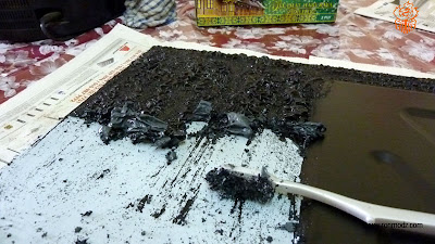

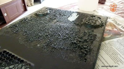

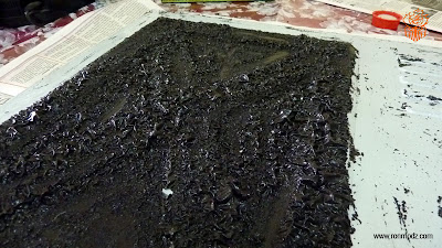

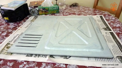

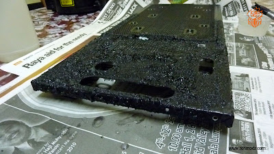

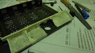

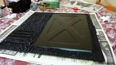

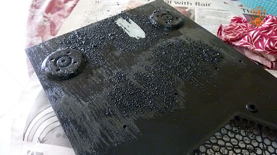

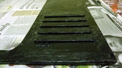

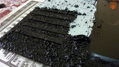

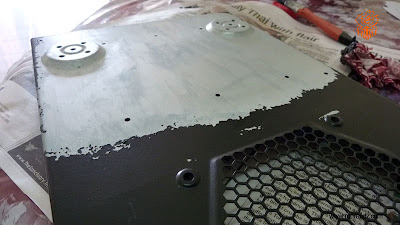

I've already done powder coating for all the internal parts now left the external parts, the 2 side windows, the top and bottom only. Since it has paint on it, i had to remove it first.
See the internal parts here : http://forum.lowyat.net/topic/1546673
Got the chemical from my cousin who is a jobber. He didn't say its name but gave me the brush on type. Apparently there is 2 types, brush on and the other is immersion which you need a tank. Don't bother trying those paint remover from the hardware shop, i've wasted 30 bucks from 3 diff shop with 3 diff brands.

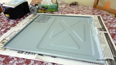

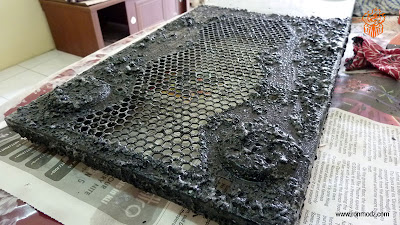

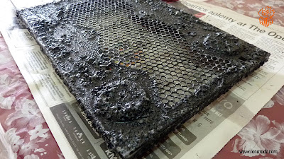

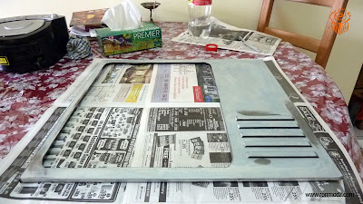

I don't know the name yet, my cousin will check for me. he got it from a supplier - a sample bottle and he gave that to me. It's a thick cloudy solution, not smelly. It was labeled as 171. Just finished the 2 side panels. Will be posting the images in a jiffy biggrin.gif Will let u know once i get the name and msds for the chemical.

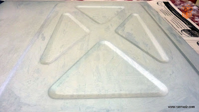

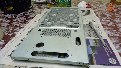

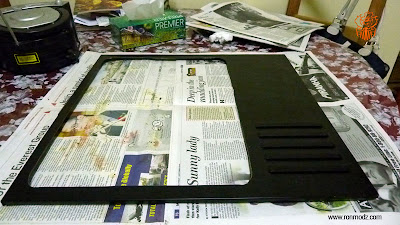

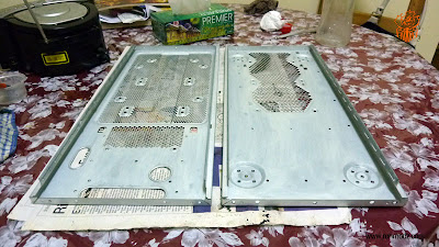

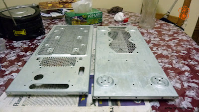

These are the remaining images. The front side window panel was a bit tough to remove, i guess they had a protective layer on top and the shiny letters of HAF. Still managed to remove all, next stop Powder Coating biggrin.gif

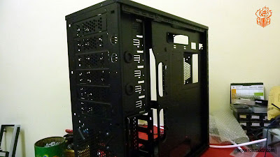

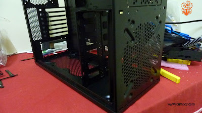

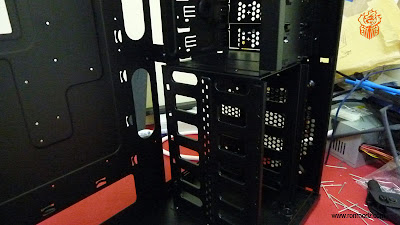

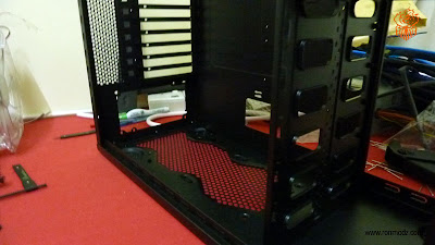

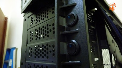

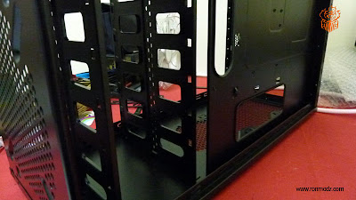

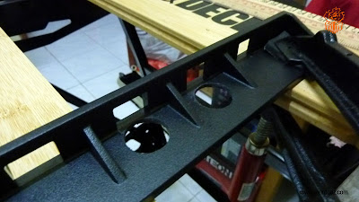

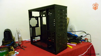

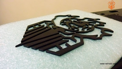

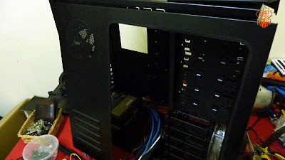

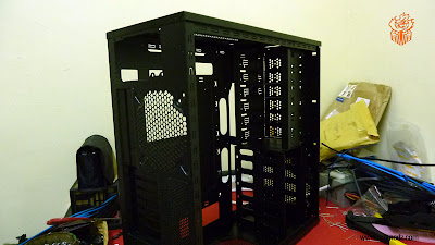

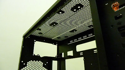

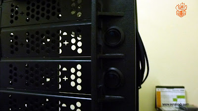

All my Cooler Master HAF 932 parts came back from powder coating. Just finished the first part of the assembly, posting the images here. Sorry, for the image quality biggrin.gif will take better ones soon. Did a custom logo and powder coated it too, will let you know where it will go in the casing, after finish arranging the custom mesh panels...Extra mesh!!! and 2 big window biggrin.gif
RonModz Logo

never done paint remover job yet. how difficult was it ?

It was ok, not so hard. Just apply on, wait for it to blister and peel, apply again till all the paint is removed and clean the surface. I bet it's much more faster if you use the immersion method. Mine was the brush on. Took about 2 days to finish, about 4 hrs a day. biggrin.gif

The whole case including my DVD-ROM covers and the steel logo - RM 186.00. Let me know early, can get group discounts biggrin.gif. I need to send my modders mesh too. Just need to finish bending and shaping it first.

u used aerosol paint remover or da liquid type?

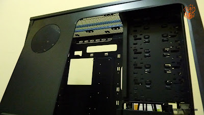

Thanks Bro biggrin.gif Will be having 2 windows on each side panel, exposed but covered with acrylic and mesh. 2 extra blowholes with mesh and few other things. Will be posting images as the work progresses biggrin.gif

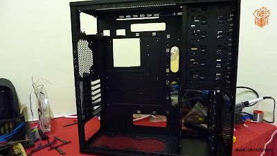

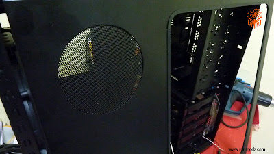

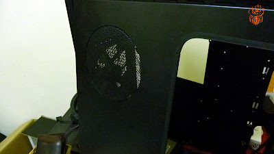

My side window mod for HAF 932, a big window and a small 120mm blow hole - no fans, just for fun biggrin.gif

The side panel that you see above is the right side panel, i used waterjet cutting service, the main side panel window is slightly bigger and i cut that myself, used jigsaw and the cutting line was not straight. So, when i went to fabricate my logo, i asked the guy favor and he did it for me biggrin.gif. It took less than 5 minutes biggrin.gif
