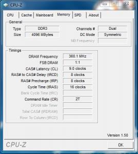

TSazlibest
post Jul 18 2010, 01:38 PM
28 posts
Joined: Feb 2009
From: penang
QUOTE(monsh @ Jul 17 2010, 11:43 AM)
use a 1:1 divider 1st la .
ensure that u eliminate 1 issue which is ram .
then start raising until ur stuck .
this is my cpuz screenshot..
all voltage i set auto..it's ok or need to overide manually??if so..how much the stable volt it should be??
This post has been edited by azlibest: Jul 18 2010, 01:40 PM
saturn85
post Jul 18 2010, 01:45 PM
Folding@home
8,686 posts
Joined: Mar 2009
people usually set voltage manually.
if leave it as auto, sometime motherboard will take control of it.
but CL9 for DDR3 720, abit loose right?
