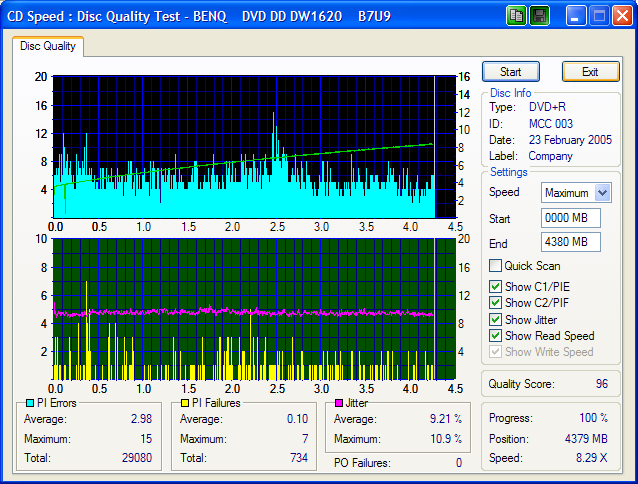

How do check original mitsubishi media ?
Retail Result : (the lowest pif , the good quality is !! )
Average PI error = 2.98
Total PI error = 29080
PI Failures = 734

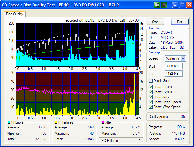

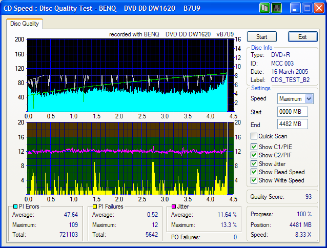

Fake Mitsubishi Result:
*i found out , many disc got scratch !! data may cause CRC ERROR
#1 disc , (MXX brand)
Average PI error = 47.64
Total PI error = 721103
PI Failures = 5642
#2 disc , (DXX brand)
Average PI error = 35.66
Total PI error = 527168
PI Failures = 33846
Data read error = 1
