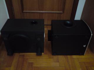

Upon unboxing the heavy package, you will found a subwoofer packed with some plastic cushions, which is not protective enough. There will be another plastic box envelops the 2 satellites, CD, User Guide, USB cable, 2x AA batteries, and Infrared Remote
Both satellites and remote are glossy, and they are covered with clear film to prevent scratch prior to removal. My infrared remote arrived with some incident, that it has a thick scratch on the numerical pad below. But my subwoofer is in perfect condition. Techgage.com's Z cinema subwoofer arrived with some cracks at the bottom.

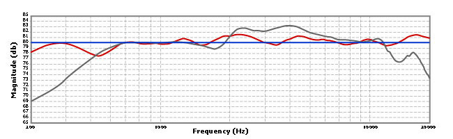

This is a pseudo-surround system. The result is crappy, as expected, but surprisingly, in certain movies with heavy-dialogues, it works pretty well in creating the virtual center speaker. However, I did modify the registry so i can gain access to the level of "focus", "tru-bass", "definition" etc.

Z-cinema internals limit the output. Note the limit is not like EIDC (Edifier Intelligent Distortion Control). The limit is on the volume output only. Only problems for me is when playing DVD in WMP or WMC the volume is lower than other media player software, so I need to use other media player.

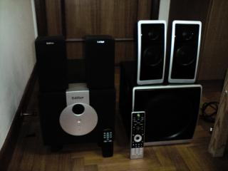

Comparing it with my Edifier R501 and Klipsch i-Fi, the Z-Cinema leaves R501 behind and positioned itself behind the ifi. it's the second best PC speaker I've ever owned, not only listened. However the brightness of the satellites seems to be disturbing me. So I leave the treble at 0 (default). Comparing the sound-stage to R501, this has definitely more soundstage. But not as much as the ifi's one. I guess that's why Alienware uses the same RSX3 satellites from Klipsch i-Fi for its Alienware ALX 5.1 Speakers apart from satellites found in Promedia 5.1 Ultra.

It's correct Logitech named the speaker Z-Cinema and Klipsch named his iFi. as the name suggest, they are actually designed to excel in specific areas. R501 is a good choice for budget users, still gives me the best gaming experience among these 3.
