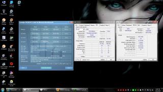

WTA about ram OC'ing, corsair xms2 ddr2 800
Jan 24 2010, 06:52 PM, updated 16y ago
#1
102 posts Joined: Apr 2009 |
for the past few days ive been running all 4 sticks at 533mhz(1066) speed with 5.7.7.24 timings.since these rams are actually ddr2 800(5.5.5.18 timings), is it safe to use this speed?voltage used now is 2.0v.i touched the ram,the heat is tolerable.its warm but not too hot though.passed occt with nil error too.i know that the performance gain is not much or none at all but if the ram is capable of running such speed then why not.
also what's the sweetest timings to go with ddr2 1066 ram?coz i think i might be able to lower the timing a bit more.so give me ur opinion k thx. This post has been edited by haf 932: Jan 25 2010, 06:29 PM Attached thumbnail(s) |

voltage is fine, speeds are fine.
sweetest possible known ddr 1066 timings are 4-4-4-10 for daily runs. unfortunately, those timings are only existent on the extinct D9GMH/GKX chipped rams. //Moved to Q&A |

2.0vdimm is very2 ok bro... u set the limit ur self...consider the air flow + heat. the sweet timing, u pick it urself..no one can tell u.. like bryan said... 1066 cl4.. i will saying 950 cl5 because different ram used..and different ramchip involved..( + the skill gap between me and bryan ofkos tighten and try urself. be heppi |

tighten ur timing more, try 5-5-5-18 or 5-6-6-6-18.
faster but larger timings doesnt give a performance boost than 800 at -5-4-4-11. This post has been edited by uzer85: Jan 25 2010, 09:34 AM |

QUOTE(uzer85 @ Jan 25 2010, 09:32 AM) tighten ur timing more, try 5-5-5-18 or 5-6-6-6-18. tried 5.5.5.18 timing last nite but failed.get d5 error from mobo.maybe i need to up the vdimm more.what the vdimm limit for corsair ddr2 eh?faster but larger timings doesnt give a performance boost than 800 at -5-4-4-11. i dun hv ram cooler installed but i dun worry bout heat much coz my killerwhale is blowing air to the ram slot. |

QUOTE(kuntawakaw @ Jan 25 2010, 10:27 AM) ts thx..i'll have a look at it.digest this http://forum.lowyat.net/index.php?showtopic=627600&hl=timing or just take a look at the graph... Added on January 26, 2010, 7:41 pmfinally settled down with 5.6.6.18 timings at 1066 speed.not bad for a cheap ddr2 800 eh This post has been edited by haf 932: Jan 26 2010, 07:41 PM |
