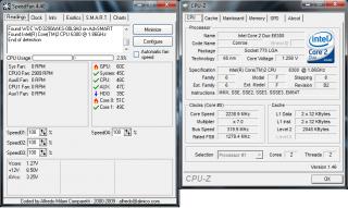

my motherboard is a Asrock g31m-s
current specs n temp of the proc is on the screenshot below....if u need anymore specs of my com just ask...

im overclocking my core 2 duo e6300..now im at 2.2ghz should i keep going..im thinking of reahing 3.0ghz on it...
my motherboard is a Asrock g31m-s current specs n temp of the proc is on the screenshot below....if u need anymore specs of my com just ask... |

Well, it's good to see a standard 450W can fire up ur rig with a 8800GTS
next, can i know what's the maximum adjustable voltage to the vcore,vdimm and vmch? |

QUOTE(Kamikaze9393 @ Jan 1 2010, 11:04 AM) my motherboard is a Asrock g31m-s This motherboard has FSB bootstrap override jumper... Check the manual. |

my max vcore should be 1.425v+..not sure of the other 2..n ya im surprise a standard 450w can support my 8800gts....
