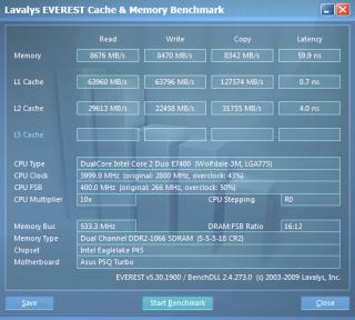

Alright, I heed your advice about the the favorable ratios for stable low PL operation and I set my Strap to 400 and the ram clock to 1066mhz, therefore achieving 3:4.
My PL is set to 8 and I 'enabled' all the 'Pull-in of CHA/B PH1/2/3/4', which in my case shows channel A 1 to 3 and Channel B 1 to 3.
As for the result above, I hope I can get lower latency in my next 'trial and error'...that is, with your kind assistance biggrin.gif

Alright, I manage to lower the PL to 7, the comp will not POST at 6.
I have my divider set @ 4:5. My guess is, i need a tighter timing on the DDR2 (4-4-4-12) to get lower than PL 7, but since my ram is 5-5-5-15 setting it to 4-4-4-12 causes the system to be unstable, hence will not perform POST. So I'm sticking with 5-5-5-15 ATM.
But to make up for the inadequacy, I manage to set the Ai Clock Twister to 'Moderate' and running it stable, will try 'Strong' later.
Here's the benching result of before and after OC'ing the system performance:
Before: (PL 12, 1:1 ratio, Ai Clock Twister on Auto and 800mhz clockspeed of ram)
Current (13/12/09): (PL 7, 5:4, Ai Clock Twister on 'Moderate' and 1000mhz clockpeed of ram)
As you can see the latency is lowered noticeably. I'm still working out on how to get the latency below 56ns, so I'm going to play around with the ratios that PL and getting the ram to stabilizes under 4-4-4-12 setting by bumping up the vDimm/vDDR or by other methods.
Hope anyone kindly can show me how you get the PL at 6, or best at 5 thumbup.gif
