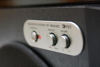

Nice photo, how's the YST-RSW300, sound?
I usually set the volume to 60-70% only.. scared the boom would cause me some problems with the neighbours sweat.gif
