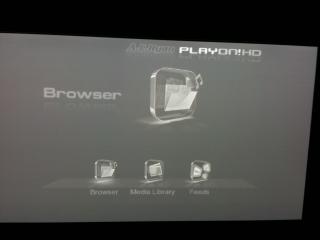

hi guys, the B&W thing happened again yesterday...i managed to snap a shot using my phone...it may not be as clear, but the best thing i have at that time was my phone...
the effect is quite similar to if u tuned the contrast low and brighten up the brightness level...everything in B&W...and quite simply, switch it off, and on again, and it's ok...
quite puzzled with this...what u guys think i should do? contact Samsung or Desa HT?

QUOTE(anfieldude @ Mar 16 2010, 05:56 PM)
Looks like a colour space mismatch or HDMI issue? Is it always on the same input? Are other inputs also in B&W when this happens?
QUOTE(de_lasoul @ Mar 16 2010, 06:52 PM)
I have the same issue with POHD, but mine is Pink and not B&W. I think this is basically a bug from POHD which failed to communicate with certain TV models. So the POHD goes into the lowest resolution mode(or default), which has compatibility issue to display properly with the TV, that is why u may experience low res and colour incompatibility. Other devices such as PS3 & Sony BD Player do not experience this.
POHD's latest firmware did mention it will solve resolution/signal compatibility with certain TV/models, I still wonder if this is the solution for your problem. But I heard this firmware is still buggy, hence I did not update accordingly.
If you wanna confirm, try another device using the same HDMI point and cable and see if you still experience the same B&W. If not, then it is from the POHD, not the TV.
its not only from POHD...i've experienced the same thing from my BD player & Astro as well..so i think it's not a problem with POHD.
QUOTE(temppei @ Mar 17 2010, 11:14 AM)
bro,
Call desa first, see what solution they can offer, if they say they can swap a new tv for u then good. if you call directly to samsung, doubt they will change a new set for u, most prolly they will take back ur unit and fix it.
just curious, is it a direct hdmi connection to your tv, or it goes thru ur amp first?
i think i might buy myself a new HDMI cable to try first before calling anyone...no spare ones currently...i really am trying to avoid having to take the tv down again sweat.gif
TV HDMI input is from AVR. all my players go through AVR...

just an update on the B&W experience i'm getting on my Samsung display. yes, the phenomenon is still happening from time to time, and i think its getting from bad to worst..
i'm now getting the B&W display, plus square boxes like an empty excel worksheet..all over the display...
but, here's what i notice so far...the B&W thing happens only IF i turn on the AVR before the TV. if i were to turn the TV on before anything else, the display is normal..
so, i'm beginning to feel the problem may not be the display after all...it could be the AVR..being switched on before TV...
maybe u guys can give it a try? if u dun mind...may not happen every time...maybe once every 5-6 try....
