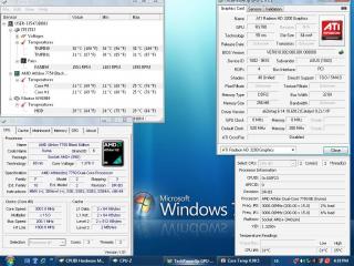

May i know how to hit more with proc AMD 7750 BE and Asus M3A78-EM mobo?
did this mobo cann't hit high to OC ???
I just try 7750 BE with M3A78-EM, but cann't hit more after OC till 3.0Ghz.....Is that the problem with mobo? or proc?
I am using below setting:
CPU/HT Reference Clock (Mhz) : 200
GPU Engine Clock : 520
PCIE Clock : 101
Processor Frequency Multiplier : x 15.0 3000Mhz
others setting all is AUTO.
So, could any buddy can teach me how the setting can hit over 3.0Ghz ???
TQ!!

i think pcie clock no need to be increased...just add "likely-to-be-rma" only..
voltage..set to a value..better not to let it auto..
the sreenshot is for idle? y not load it
see consultant here http://forum.lowyat.net/topic/1013795
many many sifu there...huhuh..im a noob..xlayak aja org

I'm no sifu but some suggestions
raise voltage to 1.4-1.45v if your mobo supports this
turn off Cool & Quiet
use a better cooler if you haven't already
Don't despair if you can't go higher than 3ghz though, usually this chip does 3.1-3.2Ghz, higher clocks are rare
I'm at 3.14ghz but with cool & quiet and asus power saving enabled with everything on auto.
Also, its best to leave your pcie clock at default, i.e. 100mhz- raising it does nothing for you.
