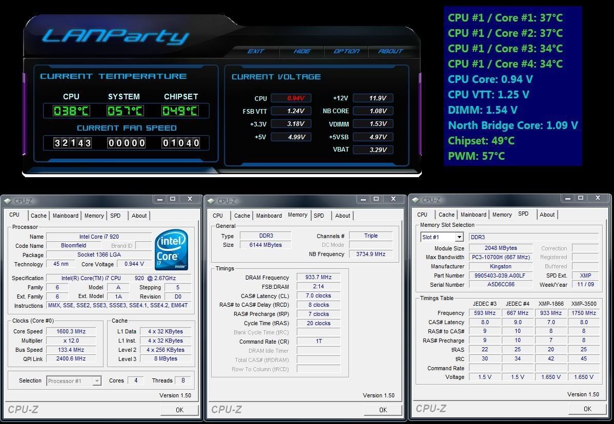

my 24/7 setup with this proc everything at default for mobo setting and proc
ht on , virtulization on ( i actually use quite a bit of this for work) , tm on , c-state auto
and power options at max saving.
This post has been edited by cstkl1: May 10 2009, 02:57 AM
