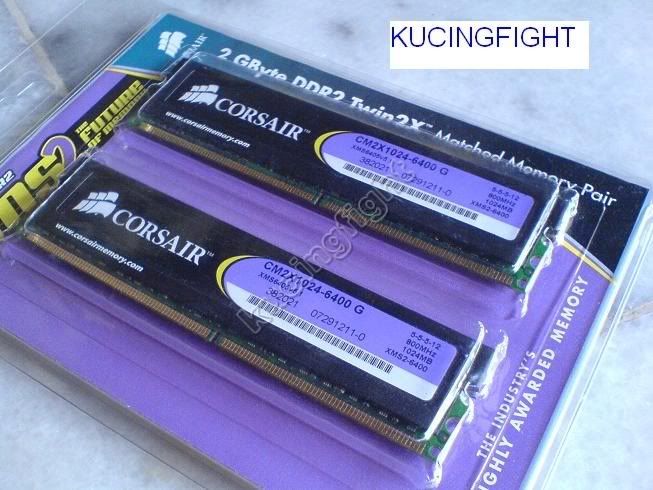

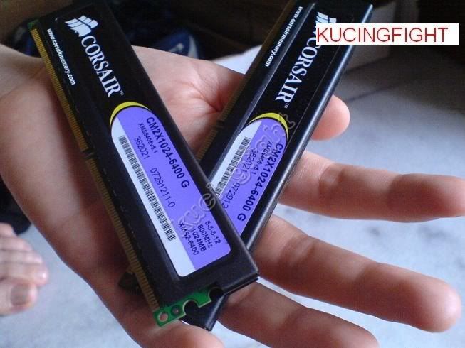

Packaging, Built Quality
The pair of 2GB Twin2x PC6400 (2x1gb) comes in a blister pack, easy & repackageable. The sticks felt 'heavy' & solid giving the impression of promising performance to come. They are rated @ 5-5-5-18 @ 1.8V @ PC6400 speeds. There are variety of revisions, and the one i have are 5.1. According to Ramlist, rev 5.1 are Promos. I would well assume they are, as obviously peeping through the heatspreader will void the warranty. The aluminum heatspreader has a nice smooth touch, with the XMS2 sticker stating the timings, rev & part number.

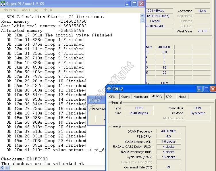

They are several methods used by reviewers to verify the overclocked results. I'll be using Super PI 32M & Prime (multi core) as stress tests to validate the results. The data represents the value which passes both sets of tests. Tests are evaluated @ CL4 & 5,varying voltage and the maximum Stable Mhz is recorded. I'll be skipping the default volts and jump right into 2.0v-2.2v.

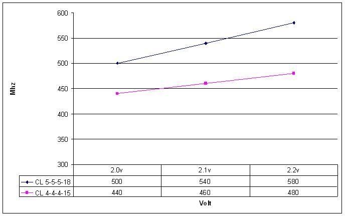

Results
Max @ CL4-4-4-15 @ 2.2v
Max @ CL5-5-5-18 @ 2.2v
Conclusion
- The sticks took me back by suprise especially @ CL5 speeds, closing up to 600mhz (DDR2 1200) speed. I did managed to boot them to Win XP @ 600mhz @ 2.3v, however, Prime would fail instantly.
- The CL4 results are nothing to shout about, but they are relatively good coming close to DDR2 1000 speeds
- Given a particular family chip, I believed Corsair has better quality (binned) chips on their memory.
- For sure, they are not meant to challenge or performed to Microns( D9GMH, GCT, GKX) which are proven superior
- They overclock relatively well, considering they are the lowest line of Corsair's Performance line, & with rm170 tagged, there are nothing much to complain about
