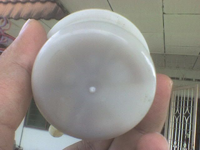

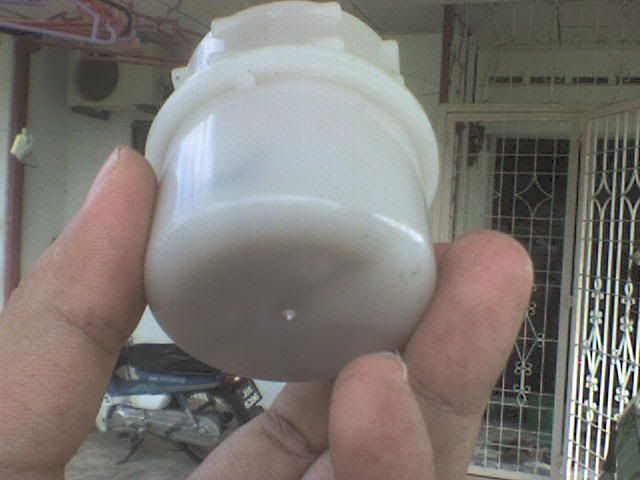

purpose of this oct.
-to keep our intake manifold, combustion chamber and exhaust as clean as possible free from engine oil vapour which could reduce your fuel octane if mixed but i could have contamidate it since i did my oct only when my mileage is around 40000km, but it is never too late.
what you need.......
-2 radiator stopper
-3 feet of hose rm3/ft
-brass y joint rm2
-used oil separator-salvage from your friend who works in a factory that have compressor
-diy holder for the oil separator
here are some picture.....
oil vapour trap after 6 days

History of my OCT.... ;D
First version...cute
Second version...ugly but practical
Third version...a little too biggggggg
Current version and i'm very satisfied.....
this is after 14 days of accumulated engine oil vapour excluding those escape through the brass filter....
After cleaning....
with better looking filter(K&N looks... ;D)
